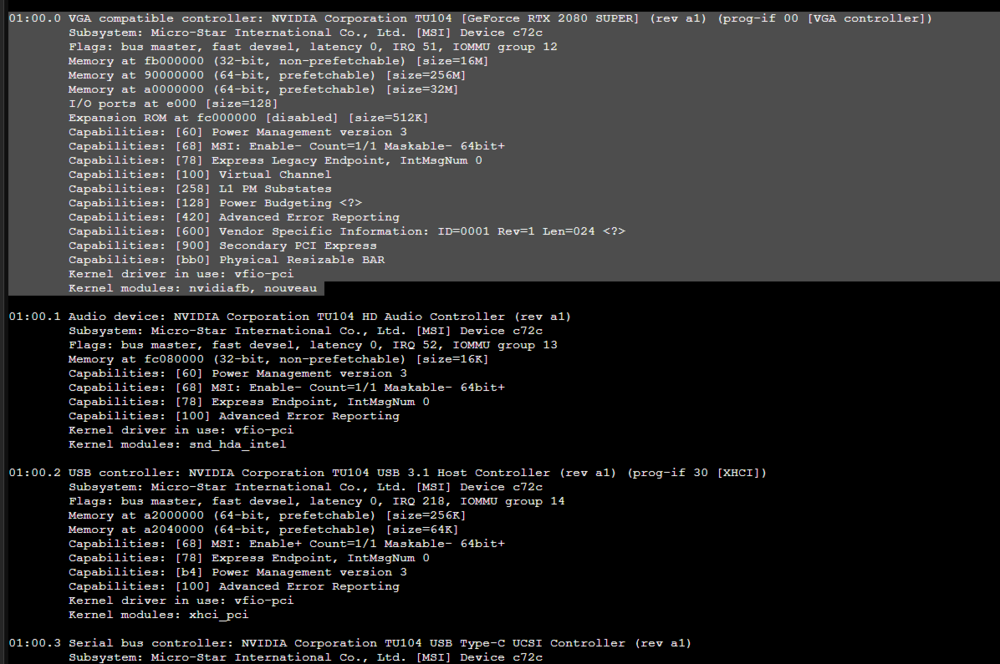

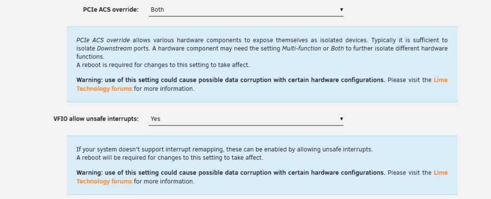

Idealy you want:
can be found via the info tab:
with adational VM settings:
then you want the g card vfio bound IT MUST BE BOUND AND NOT TOUCHED BY THE HOST to be corectly passed into a windwo VM
example this card is not bound to vfio (example only)
*Not the kerneal driver in use... this needs to be vfio-pci!
Example with nvidia... note all parts are vfio-pci (EXAMPLE ONLY!)
so make sure your device is selected and vfio bound / stubed

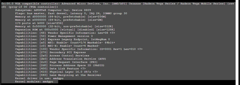

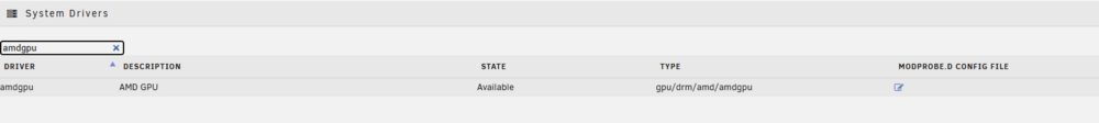

softdep amdgpu pre: vfio vfio_pci
in my example for my amd vega Since lspci -v says that my driver in use is amdgpu I would need to softdep a modprobe option to help devices enter vfio-pci.

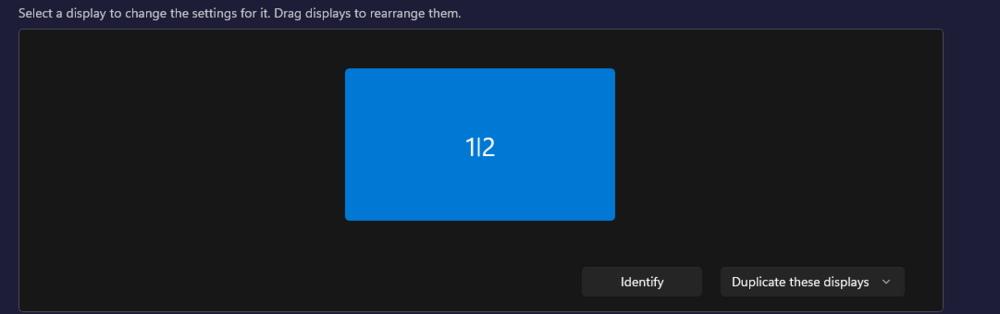

Alright, I've followed all of that and still not working all the way. I do at least get something on the display now but not actual video.
I also get this when I remotely connect into the VM for the displays.

Here is my diagnostic file and the output from lspci -v
00:00.0 Host bridge: Advanced Micro Devices, Inc. [AMD] Starship/Matisse Root Complex

if you open windows display setting does it see another display? if yes then this is unraid spice/default vnc dispaly issues and teh amd gpu need to be marked the primary gpu...
I'm usig prox vm example and use parsec to rdp adn instaleld a virtual display so I would see 2 and duplaict to assit rdp conection back to my passthrough device:
I am only ever able to get it to show the VNC connection and a AMD VDisplay. I attempted to dump the VBIOS using the SpaceInvader script but it fails every time when it tries to wake the server back up from sleep.

root@Tower:~# lspci -vv -s 21:00.0
21:00.0 VGA compatible controller: NVIDIA Corporation AD104 [GeForce RTX 4070] (rev a1) (prog-if 00 [VGA controller])
        Subsystem: Gigabyte Technology Co., Ltd Device 40ee
        Control: I/O+ Mem+ BusMaster+ SpecCycle- MemWINV- VGASnoop- ParErr- Stepping- SERR- FastB2B- DisINTx+
        Status: Cap+ 66MHz- UDF- FastB2B- ParErr- DEVSEL=fast >TAbort- <TAbort- <MAbort- >SERR- <PERR- INTx-
        Latency: 0, Cache Line Size: 64 bytes
        Interrupt: pin A routed to IRQ 305
        IOMMU group: 49
        Region 0: Memory at c2000000 (32-bit, non-prefetchable) [size=16M]
        Region 1: Memory at a400000000 (64-bit, prefetchable) [size=16G]
        Region 3: Memory at a800000000 (64-bit, prefetchable) [size=32M]
        Region 5: I/O ports at 3000 [size=128]
        Expansion ROM at c3000000 [disabled] [size=512K]
        Capabilities: [60] Power Management version 3
                Flags: PMEClk- DSI- D1- D2- AuxCurrent=0mA PME(D0+,D1-,D2-,D3hot+,D3cold-)
                Status: D0 NoSoftRst+ PME-Enable- DSel=0 DScale=0 PME-
        Capabilities: [68] MSI: Enable+ Count=1/1 Maskable- 64bit+
                Address: 00000000fee00000  Data: 0000
        Capabilities: [78] Express (v2) Legacy Endpoint, IntMsgNum 0
                DevCap: MaxPayload 256 bytes, PhantFunc 0, Latency L0s unlimited, L1 <64us
                        ExtTag+ AttnBtn- AttnInd- PwrInd- RBE+ FLReset+ TEE-IO-
                DevCtl: CorrErr+ NonFatalErr+ FatalErr+ UnsupReq+
                        RlxdOrd+ ExtTag+ PhantFunc- AuxPwr- NoSnoop- FLReset-
                        MaxPayload 256 bytes, MaxReadReq 512 bytes
                DevSta: CorrErr+ NonFatalErr- FatalErr- UnsupReq- AuxPwr- TransPend+
                LnkCap: Port #0, Speed 16GT/s, Width x16, ASPM L1, Exit Latency L1 <4us
                        ClockPM+ Surprise- LLActRep- BwNot- ASPMOptComp+
                LnkCtl: ASPM Disabled; RCB 64 bytes, LnkDisable- CommClk+
                        ExtSynch- ClockPM- AutWidDis- BWInt- AutBWInt- FltModeDis-
                LnkSta: Speed 16GT/s, Width x16
                        TrErr- Train- SlotClk+ DLActive- BWMgmt- ABWMgmt-
                DevCap2: Completion Timeout: Range AB, TimeoutDis+ NROPrPrP- LTR-
                         10BitTagComp+ 10BitTagReq+ OBFF Via message, ExtFmt- EETLPPrefix-
                         EmergencyPowerReduction Not Supported, EmergencyPowerReductionInit-
                         FRS-
                         AtomicOpsCap: 32bit- 64bit- 128bitCAS-
                DevCtl2: Completion Timeout: 50us to 50ms, TimeoutDis-
                         AtomicOpsCtl: ReqEn-
                         IDOReq- IDOCompl- LTR- EmergencyPowerReductionReq-
                         10BitTagReq- OBFF Disabled, EETLPPrefixBlk-
                LnkCap2: Supported Link Speeds: 2.5-16GT/s, Crosslink- Retimer+ 2Retimers+ DRS-

I attempted to run the reset script and it can't seem to run it. Here are my GPU devices and the logs from the script.
I also used all three of the Vbios from techpowerup for my card and none of them helped.
I had to double check to make sure I was using the correct terms but you have the wrong values for GPU and AUDIO in your script so it isn't finding them. It looks like you put 1002:7550 and 1002:ab40 which are the vendorID:deviceID I believe. You need the ones just to the right of that, with the leading zeros as in the example. For your setup, this is what you need:
GPU="0000:0c:00.0"
AUDIO="0000:0c:00.1"
It may not be needed for this but it's good to know for future reference. Also, in line with what bmartino1 said, the VNC could further complicate things. It's best to remove it and only have the real GPU in your VM config.
