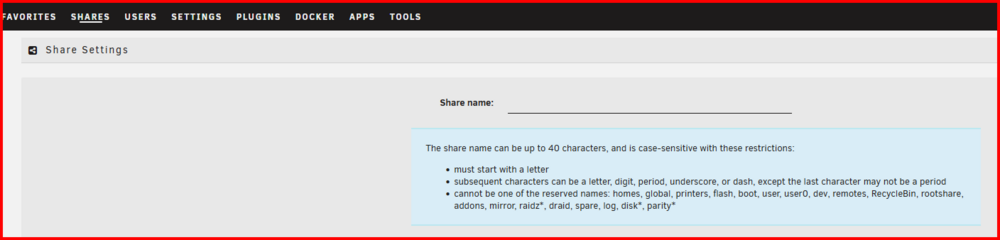

Next thing: There are restrictions on Share names. This screenshot is from the Add Share page on the GUI:

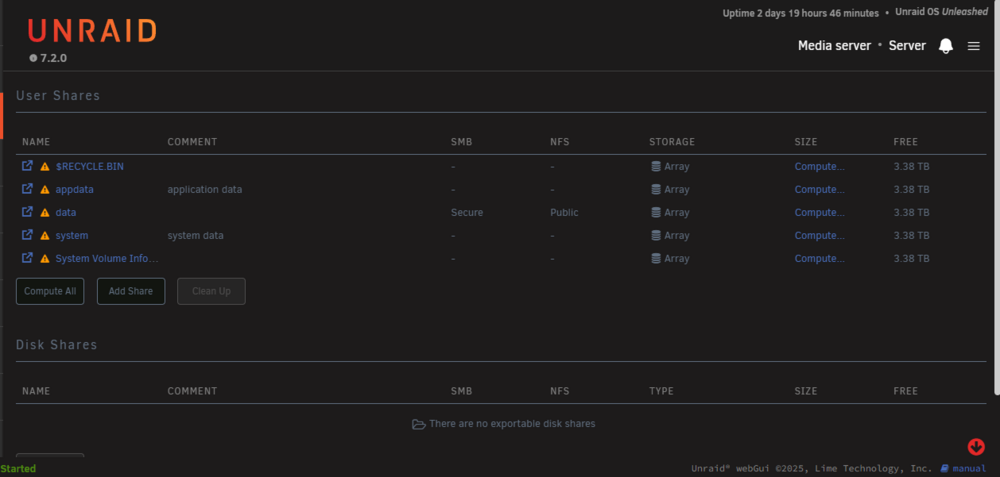

Another thing, you have not configured the $------------------N and the S----------------n shares. You do this from the Share Page....
The D---a Share is configured as 'Secure' and you say you are accessing it from a Windows vm. (With Secure, you will require a login to copy/write to that share.) You do realize that Windows now requires that you log into any server with a valid user account on that server. You can find instructions for setting that up here:

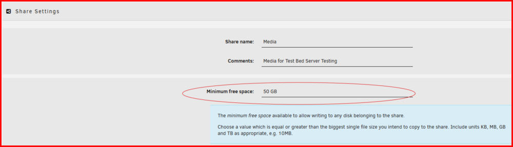

Let's try this. Go to Shares and click on your 'data' share name under "User Shares". Then set 'Minimum free space:' according to the instructions below in this screenshot. (Your present setting looks like the default setting which is usually way too large.)
Edited by Frank1940
