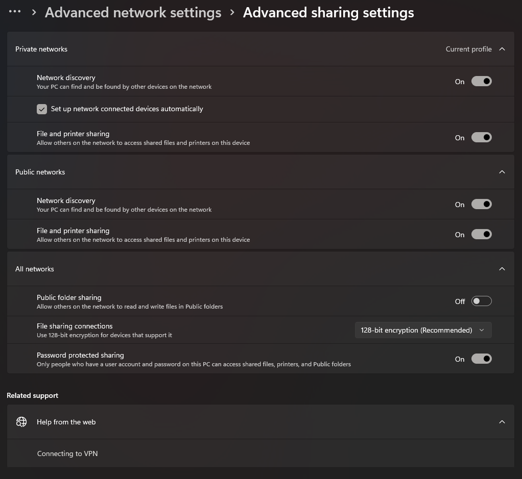

These are my settings for Windows sharing and it's set for Private network.

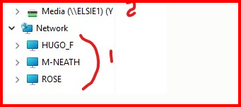

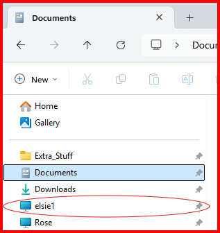

When the problem is this:
Where the Unraid server (or even a Windows peer-to-peer client-server) does not appear under the Network section! Observe that in the case that I am showing the server ELSIE1 is available and being used in mapping a network drive. Yet, it does not show up under the Network section. In this case, typing \\ELSIE1 will find the server but that can be a real nuisance if you have to do several times a day. Pinning it to the 'Quick Access' section is a very simple solution and it will always be there for instant use. See below:
