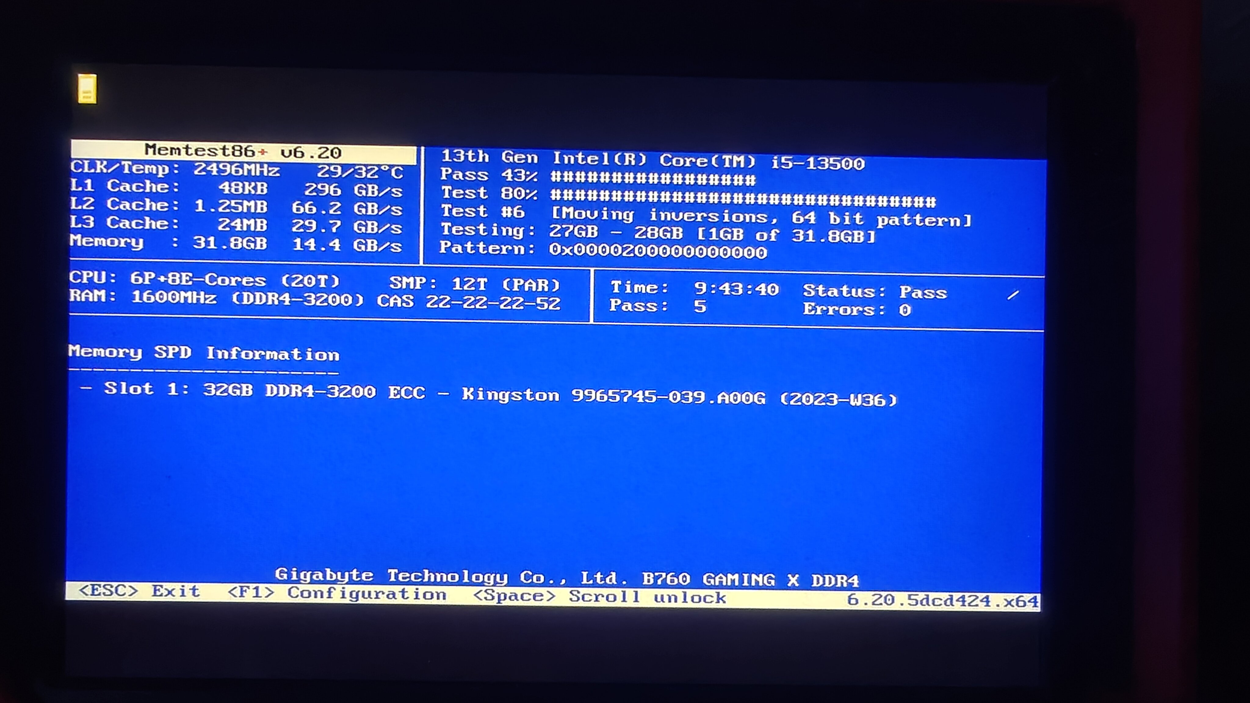

  • I memtest'ed only the one 32GB DIMM: pass
  • I memtest'ed only the 2x 8GB Kit: pass

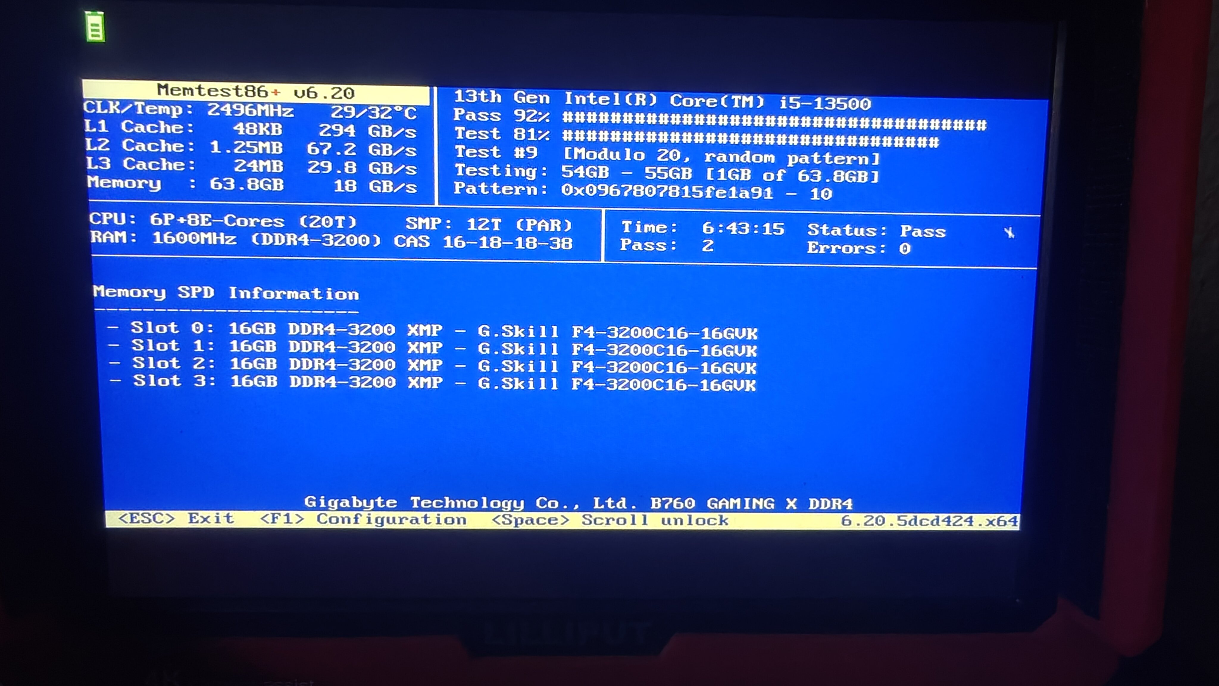

  • I installed this 64GB kit, memtest'ed it: pass

I attached two logs, for crashes that happened; I guess there's nothing of value in there. I attached Diagnositics from just now, and two photos of the memtest (which also only kinda add frustration as I'd love find a hard reason why it happens, haha)
