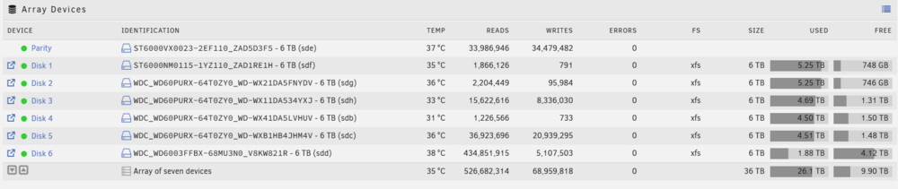

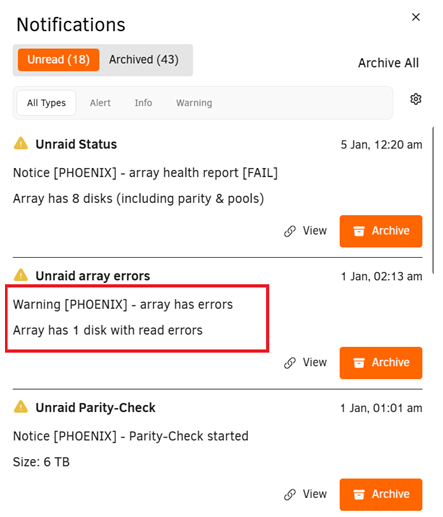

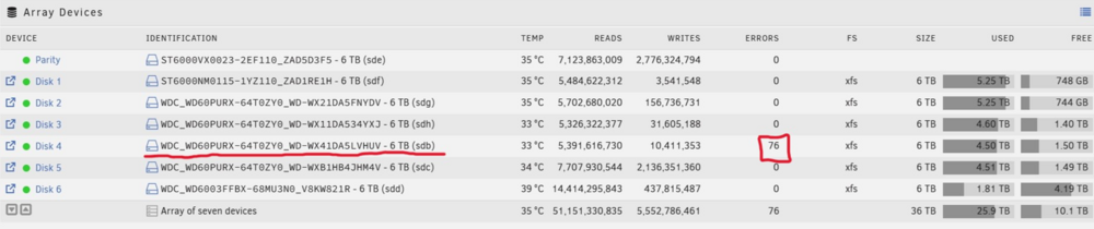

I received a warning that one of my array disks had 76 read errors;
So I powered the server off, fitted a new 6Tb disk in a spare slot and successfully precleared it ready to replace this one with errors.
But, now the disk which had read errors is showing no errors...
I am guessing its reset because the machine has been rebooted... is it not showing these read errors now because it hasnt tried to read from the 'failed' sectors, or has the reboot cleared the fault so the disk doesnt need replacing?

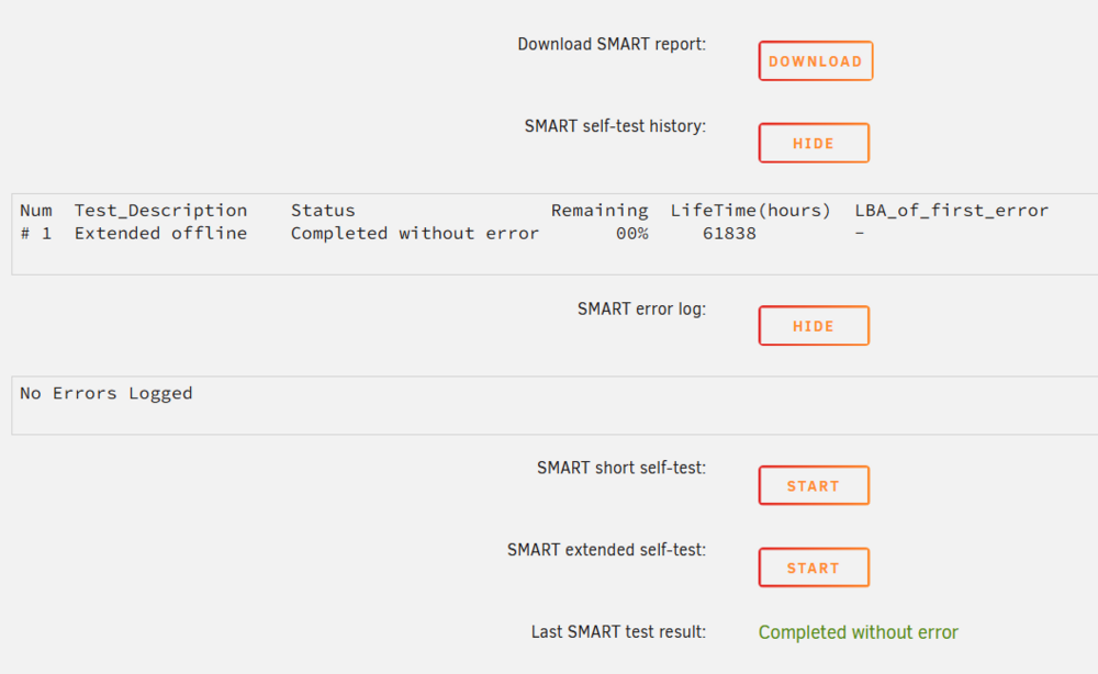

Diags are after a reboot, so we can't see the errors, but in SMART they were logged as disk problem, so recommend running an extended SMART test on that disk.
On 1/15/2026 at 7:46 AM, JorgeB said:
...recommend running an extended SMART test on that disk.
Not sure why UnRAID reported read errors and then shows "completed without error"... unless I am missing something?
I have attached the SMART report too.
phoenix-smart-20260117-2032.zip
Because there were read errors before, but the SMART test passed, so the disk is OK for now, keep monitoring.

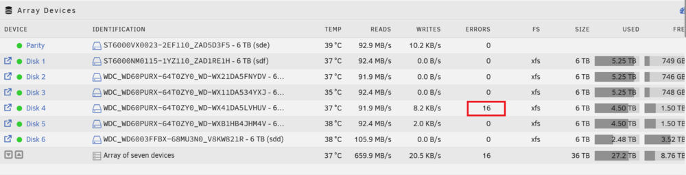

Hi all, I am re-opening this as the same disk has started reporting read errors again... so I am pretty sure its on its way out;
This machine is remote, so after the first time I was getting these errors I installed a new disk and ran Preclear on it. So, this disk is already in the machine ready to be added to the array. Is the correct process to just re-assign disk 4 to the new one, or do I need to unassign the existing disk 4 - reboot and then assign the new disk to start the rebuild? Its a while since I have had a disk fail, so just need to make sure I am following the correct process. Current diags attached :-)
