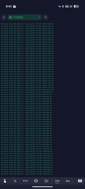

I checked and saw that my server is hitting over 500ms ping spikes when pinging the gateway. At first I thought it was just a bad network cable, so I changed it out, but the same thing is still happening.
I was looking into it and saw that shfs is using somewhere around 200% CPU. I really don't know what it is and I haven't modified any settings lately. My only recent changes were adding a parity disk and a new M.2 SSD (which is where my appdata is hosted now). Those changes were a few months ago, but this problem just started showing up at the end of 2025.
I’ve been trying to fix it by myself since then with no luck and I still can't figure out what's causing it. I've attached my diagnostics and a screenshot of the spikes.

I was able to get two diagnostics just now lol. I just had two massive spikes, so I started the diagnostic as soon as the ping started spiking.
As you can see the ping goes very high making a lot of stuff thinking its down
