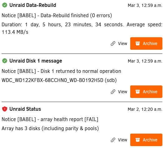

Few concerns:
1. This error showed up during the rebuild: Notice - Array health report [FAIL], Array has 3 disks (including parity & pools) - see screenshot. From this post apparently this is intended, but I'm bringing it up along with diagnostics just in case (and because of concern #2)
