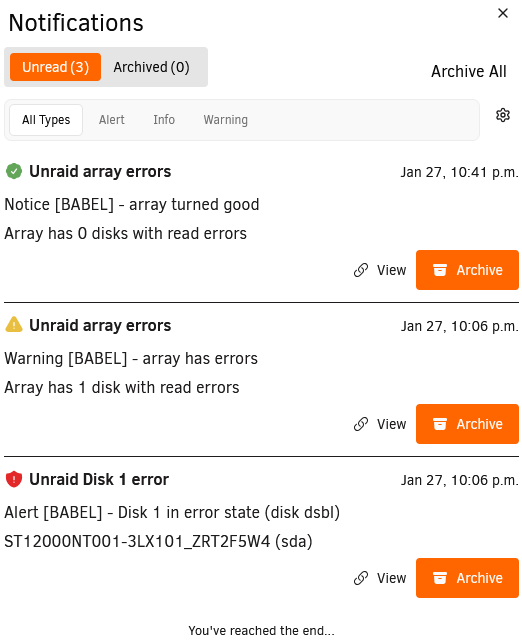

Disk 1 Read Error
I got an alert about a disk read error on my server. From searching around I decided to stop and rerun the array (not reboot), and a message saying that the "array turned good" popped up.
I am not sure how to proceed from here. The server itself is barely 3 months old and has worked perfectly fine up till now, so I'm not sure if or why one of them crapped out. Anyways I have attached the diagnostics.

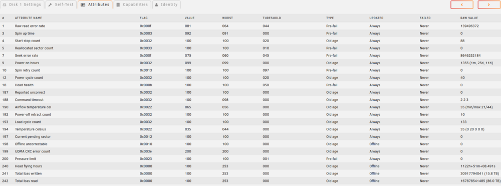

In case the SMART data doesn't show up again, here's a direct screenshot from the GUI
You can examine your diagnostics yourself. SMART reports for all attached disks is in the smart folder.

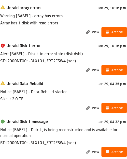

Is it time to RMA the drive? More read errors were encountered while rebuilding on the same disk. From the logs, example: Jan 29 22:15:25 Babel kernel: md: disk1 write error, sector=10097871664
Everything critical is backed up so I'm not worried if the parity (from the same batch of drives) also happens to fail. Diagnostics (maintenance mode) attached

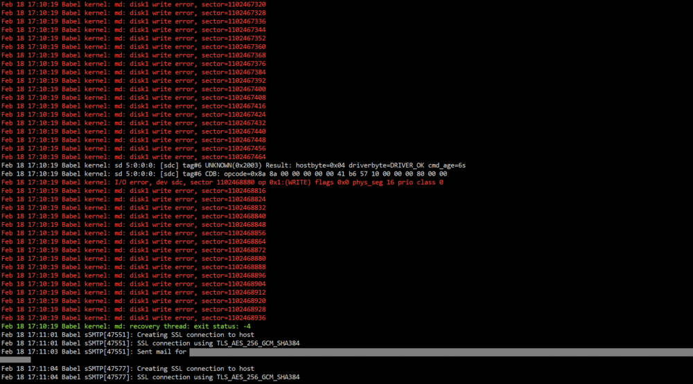

Rebuilding on top constantly fails. I have changed the SATA cables again, using Startech instead of Aliexpress stuff, and the rebuild failed via the linked directions. Also, the disk dropped off the array completely as if it were removed from its bay. So I tried again, changing the bay the affected hard drive was in, in case there was an issue with the SATA backplane. Same issues as before, with the rebuild failing. Diagnostics attached along with a screenshot of the log after the second rebuild attempt failed.
I am not sure where to proceed as I have replaced all SATA cables with brand-name stuff, changed ports on the motherboard (I have 6 SATA ports), and reseated all other cables. Is it time to RMA the drive? It's making a different noise than usual upon startup, with more clicking than usual.
