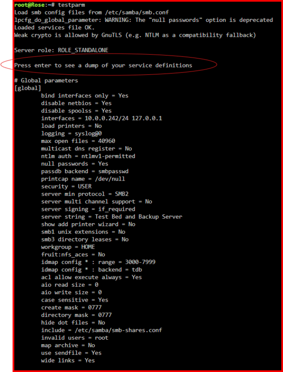

Next thing-- Post up a screen shot of the output of this command
testparm
This part is needed as it shows the options/parameters that have been changed from the Samba defaults:
Note that you have to press <ENTER> to get the listing.
(If you copy-and-paste the output, please format it it as " </> Inline Code" before posting. It is a option listed under the '...' in the posting entry toolbar. )
