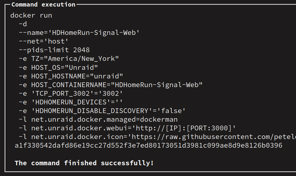

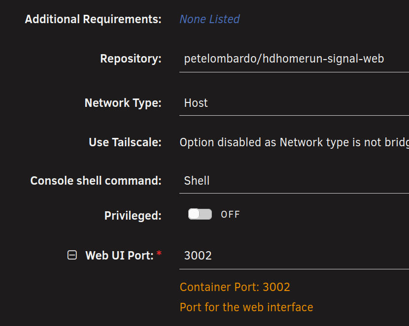

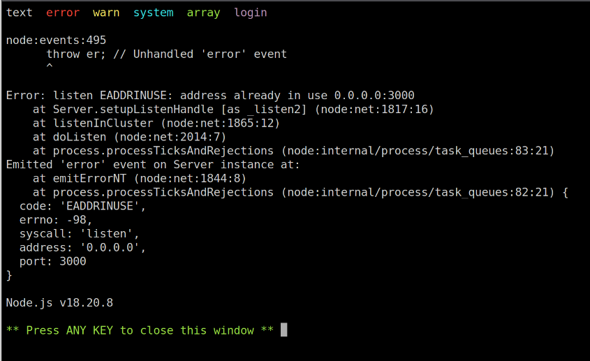

Changing the port from 3000 does not change behavior. I already have a container using 3000. If I set HDHomerun Signal Web to use 3002, it "starts", but when I click "WebUI", I am brought to the WebUI of the container on port 3000.

Typically with docker, you don't edit the container port, you edit the host port. That is what port mapping is all about.

It should just be
-e PORT=3002
It's necessary with this app for auto discovery to work properly. It needs host mode networking, so docker is unable to forward ports. The app does support port forwarding as well, though, you simply need to specify the IP or hostname of your hdhomerun.

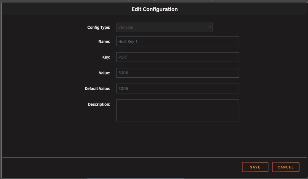

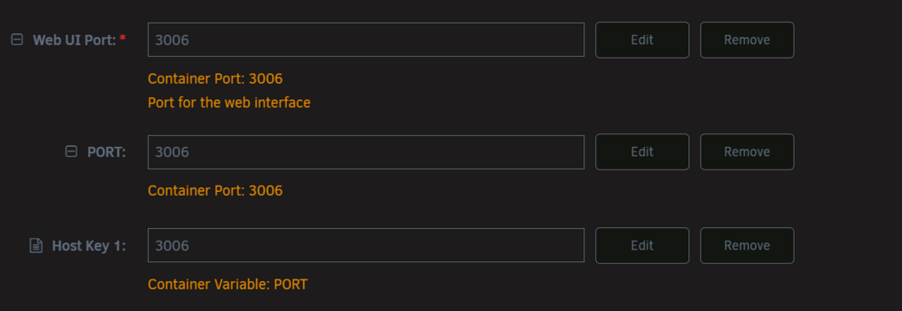

I got it working by adding Variable "PORT" = 3006
I just pushed an update to the containers that allows you to use the default bridge-mode networking along with port mappings so that you can use the traditional means (not environment variables) to modify the ports. The only caveat is for auto-discovery to work in bridge mode, you need Internet access. If you need auto-discovery to work without Internet access, then you need host mode networking. The changes are backwards compatible - there should be no interruptions to existing deployments.
