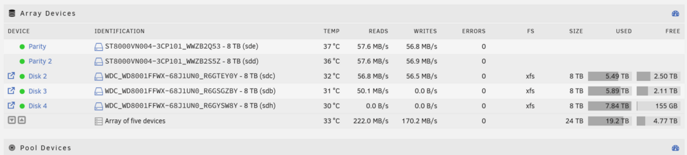

Fairly new to unraid here. I recently copied roughly 7 tb of data using krusader from an unassigned device to a share. Now I see read on one drive in the array and write on another drive. The log confirms that files are moving from one drive to another. So far I have seen drive 2 move assets to drive 3 until drive 3 is full, then it begins moving assets from drive 2 to drive 4 until drive 4 is full. Now I am seeing it move assets from drive 3 back to drive 2. Any ideas why this would be happening? The share I copied to is also synchronized to another off site server using resilio sync, but has reached 100% sync so no new files should be overwritten through that. No other docker apps are running.

I don't follow what you mean, please post a screenshot of mains with read/write stats enabled and also the diagnostics.

Sure this is the entry I am seeing in the log. It is a continuous list of these entries as it moves files. Yesterday the log was showing the path as /mnt/disk2 and the read/write confirmed the data was moving between disk 2 and 4, now it is showing data moving from disk 3 to 2. which I can confirm because the available space and size of the share on each drive is changing.
Feb 25 09:14:39 Tower move: move: /mnt/disk3/assets/3D/Quixel/Megascans/Downloaded/3d/Cement_Curbs_sepxV_8K_3d_ms/Curb_Cement_Medium_Grey_Dirty_sepxV_8K_Albedo.jpg Success
Feb 25 09:14:40 Tower move: move: /mnt/disk3/assets/3D/Quixel/Megascans/Downloaded/3d/Cement_Curbs_sepxV_8K_3d_ms/Curb_Cement_Medium_Grey_Dirty_sepxV_8K_Bump.jpg Success
Feb 25 09:14:40 Tower move: move: /mnt/disk3/assets/3D/Quixel/Megascans/Downloaded/3d/Cement_Curbs_sepxV_8K_3d_ms/Curb_Cement_Medium_Grey_Dirty_sepxV_8K_Cavity.jpg Success
