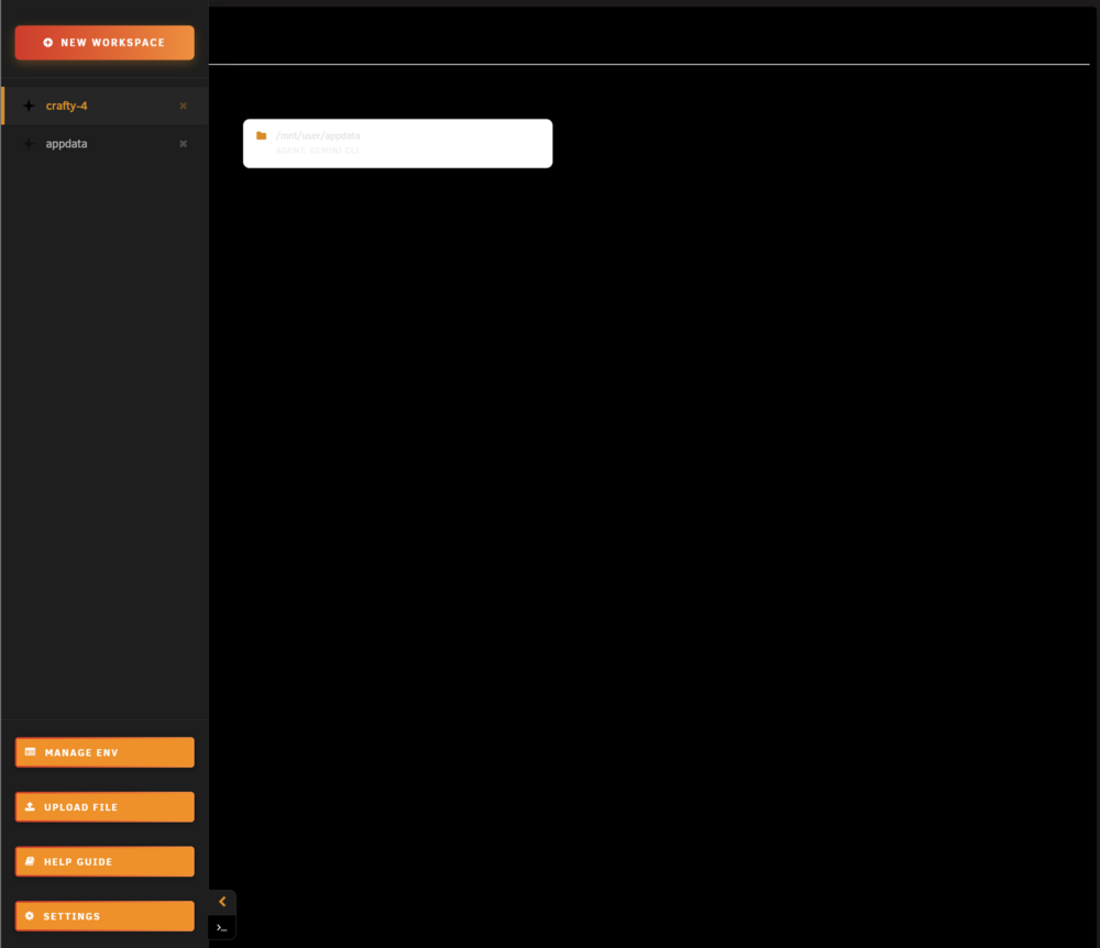

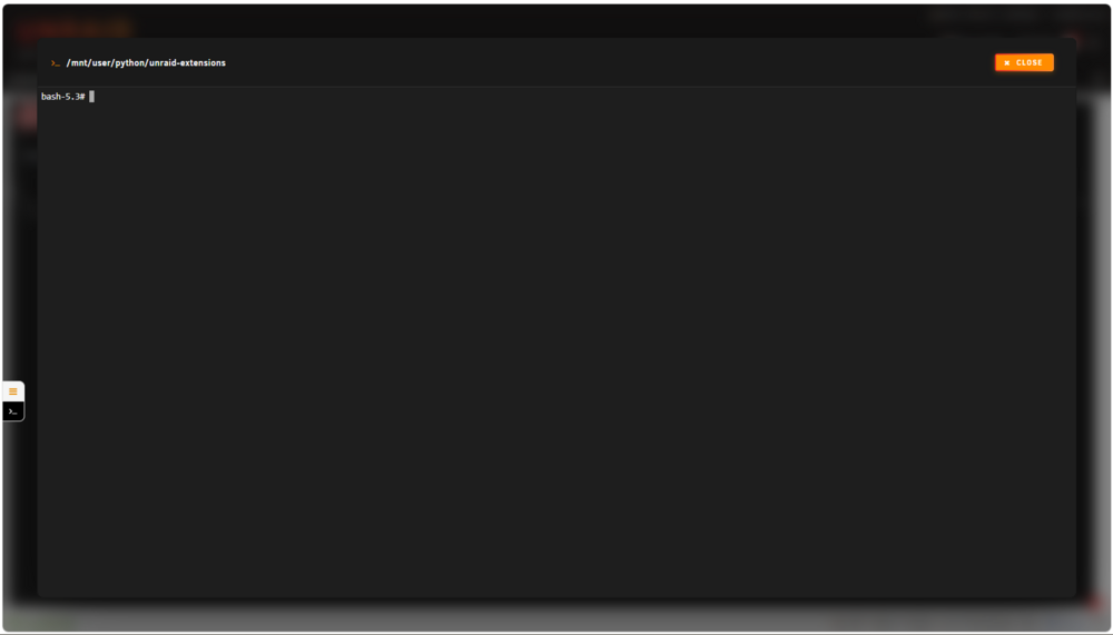

The latest version should have a small terminal icon button on the little drawer tab to launch a pop up terminal with the home set and workspace path ready to go.

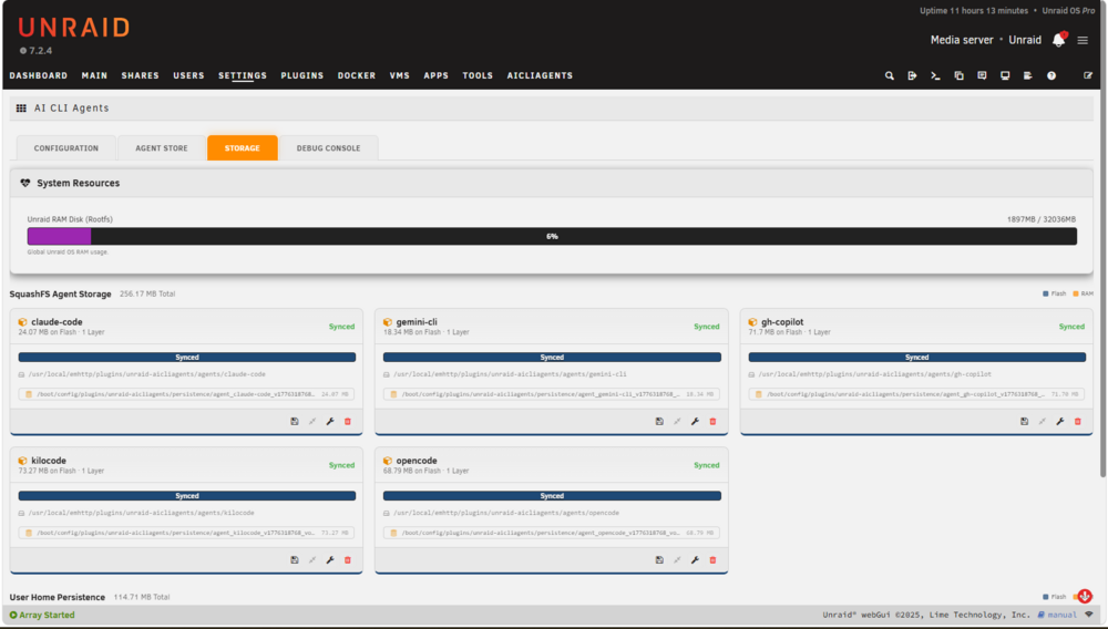

Ok so I think the best I can do is use a similar approach to limetech, and use squashFS, it'll give a similar outcome to a compressed btrfs loopdevice without the complexity. I'll split the agents across files to minimise risk of hitting the 4gb fat32 limit on the USB. I'll need to figure this all out!

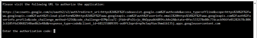

Sorry, im' new to running CLI agents - is there no way to use your Google AI Plan account? Only using the Gemini CLI API key? When running Gemini CLI locally, i can choose to use a google account.

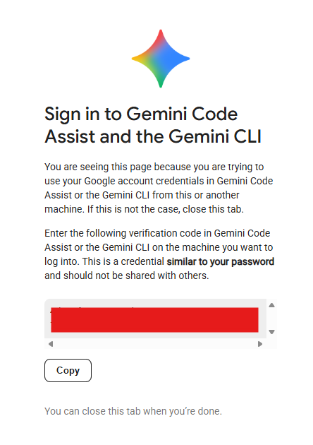

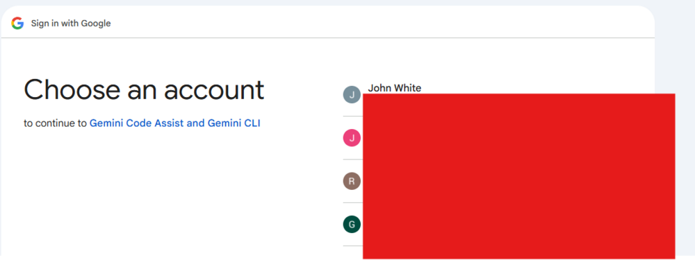

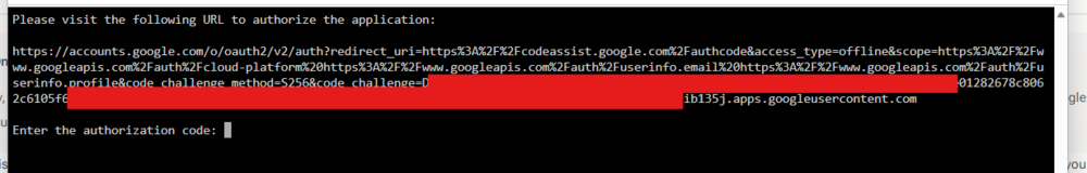

yes this is how i run. When you first run the gemini cli tool, you select the first option (Sign in with Google), it will then displace a web link, you click that, it'll open the google sign in page in you browser, and once you've given it permission, you copy the code, go back to Unriad AI CLI TAB and paste in the code, it will then persist this in the home storage for gemini cli for all worksapces you use it on.
So on launch you'll see this, if not type /auth and select sign out and relaunch
Then you'll get:
You should be able to click the HTTPS link
Click and sign in then:
Click copy, and paste in the terminal (see first screenshot)

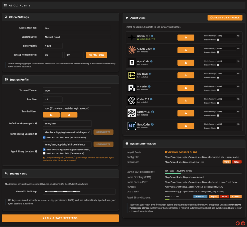

Hi, I'm having trouble with "Failed to mount Home storage for root" errors:
[2026-04-11 12:30:58] [INFO] MAINTENANCE: Unlocking Agent storage (RO -> RW)[2026-04-11 12:30:58] [WARN] Mnt Attempt 1 failed: mount: /usr/local/emhttp/plugins/unraid-aicliagents/agents: cannot remount /dev/loop4 read-write, is write-protected.        dmesg(1) may have more information after failed mount system call.[2026-04-11 12:30:59] [WARN] Mnt Attempt 2 failed: mount: /usr/local/emhttp/plugins/unraid-aicliagents/agents: cannot remount /dev/loop4 read-write, is write-protected.        dmesg(1) may have more information after failed mount system call.[2026-04-11 12:31:00] [WARN] Mnt Attempt 3 failed: mount: /usr/local/emhttp/plugins/unraid-aicliagents/agents: cannot remount /dev/loop4 read-write, is write-protected.        dmesg(1) may have more information after failed mount system call.[2026-04-11 12:31:00] [WARN] STALL: Remount RW failed. Triggering robust repair sequence...[2026-04-11 12:31:00] [WARN] Btrfs Rescue: Processing /mnt/user/appdata/aicli-persistence/aicli-agents.img mounted at /usr/local/emhttp/plugins/unraid-aicliagents/agents[2026-04-11 12:31:01] [INFO] Btrfs Rescue: Success for /mnt/user/appdata/aicli-persistence/aicli-agents.img
[2026-04-11 12:31:44] [INFO] Mounting Btrfs Home (RAM) for root...[2026-04-11 12:31:44] [ERROR] ERROR: Failed to mount Home storage for root.[2026-04-11 12:31:57] [INFO] startAICliTerminal called: ID=sz9cv0, Agent=gemini-cli, Path=/mnt/user/appdata[2026-04-11 12:31:57] [INFO] Mounting Btrfs Home (RAM) for root...[2026-04-11 12:31:57] [ERROR] ERROR: Failed to mount Home storage for root.[2026-04-11 12:32:01] [INFO] startAICliTerminal called: ID=temp-terminal, Agent=terminal, Path=/mnt/user/appdata[2026-04-11 12:32:01] [INFO] Mounting Btrfs Home (RAM) for root...[2026-04-11 12:32:01] [ERROR] ERROR: Failed to mount Home storage for root.[2026-04-11 12:32:08] [INFO] startAICliTerminal called: ID=temp-terminal, Agent=terminal, Path=/mnt/user/appdata[2026-04-11 12:32:08] [INFO] Mounting Btrfs Home (RAM) for root...[2026-04-11 12:32:08] [ERROR] ERROR: Failed to mount Home storage for root.[2026-04-11 12:35:21] [INFO] startAICliTerminal called: ID=sz9cv0, Agent=gemini-cli, Path=/mnt/user/appdata[2026-04-11 12:35:21] [INFO] Mounting Btrfs Home (RAM) for root...[2026-04-11 12:35:21] [ERROR] ERROR: Failed to mount Home storage for root.[2026-04-11 12:35:32] [INFO] startAICliTerminal called: ID=sfrv5k, Agent=gemini-cli, Path=/mnt/user/appdata/crafty-4[2026-04-11 12:35:32] [INFO] Mounting Btrfs Home (RAM) for root...[2026-04-11 12:35:32] [ERROR] ERROR: Failed to mount Home storage for root.[2026-04-11 12:36:26] [INFO] startAICliTerminal called: ID=temp-terminal, Agent=terminal, Path=/mnt/user/appdata/crafty-4[2026-04-11 12:36:26] [INFO] Mounting Btrfs Home (RAM) for root...[2026-04-11 12:36:26] [ERROR] ERROR: Failed to mount Home storage for root.[2026-04-11 12:43:04] [INFO] startAICliTerminal called: ID=sfrv5k, Agent=gemini-cli, Path=/mnt/user/appdata/crafty-4[2026-04-11 12:43:04] [INFO] Mounting Btrfs Home (RAM) for root...[2026-04-11 12:43:04] [ERROR] ERROR: Failed to mount Home storage for root.
The plugin page looks like this:
I'm using Gemini if that matters.
Here's my settings page:
Any help would be amazing.
Thanks!

Hi, sorry I’ve been busy refactoring and uplifting the storage architecture, it will be a lot more standard and reliable. It’s nearly done, there are a lot of test cases to work through! Likely another day or so.
OK... new version out with LOTS of fixes and changes.
Let me know if any issues and any features you want to see.

Getting an Error
Terminal session not found. Check debug log.
