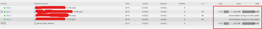

Disk 2 and Disk 3 showing Unmountable: Wrong or No File System
Team,
Hope the weekend went well, I am having two issues with my Unraid v7.2.3 server.

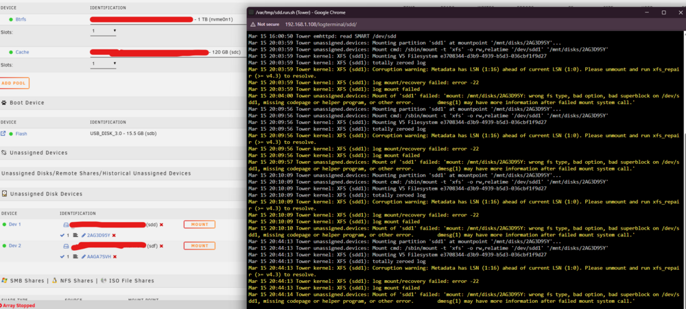

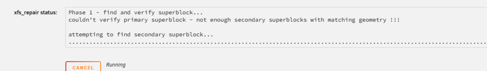

1) I've been having issues with running my Unraid NAS server in headless mode, causing me to have to shutdown, add the graphics card back in and keep editing BIOS settings to see the URL will load. While doing this I noticed Disk 2 and Disk 3 showing up as unmoutable, wrong or no file system. I stopped the array and unassigned both disks and tried the mount button, but it came back with failed, check syslogs. Next I added them both back and started the array in maintenance mode, tried Check Filesystem Status for both disks. xfx_repair status did not get past, attempting to find secondary superblock. I checked PHP Settings logs and they are empty.
Before I click format both drives I wanted to reach out and see if there is anything I missed or another step to take. My parity drive and disk1 are both valid and working properly, no data has been lost. I also shut down the system from web URL and reset SATA cables at the motherboard but that did not resolve my issue.

Let it try longer to find secondary superblock
I will let it run for 24hs and report afterwards.

still looking for secondary superblock
Start the array in normal (not maintenance) mode and post new diagnostics
You can cancel that; if it hasn't found a backup superblock after 1 or 2 hours, it won't find one.

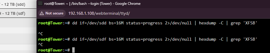

Your only option now may be using a file recovery app like UFS Explorer, but let's see if there's a second signature, with the array stopped type.
dd if=/dev/sdX bs=16M status=progress 2>/dev/null | hexdump -C | grep 'XFSB'
Replace X with the identifier from one of those disks, then let it run for 5 minutes and post the output
I ran the command for both disks for about 10min with nothing returned.
That means the disks don't have the correct XFS superblock; the best option may be UFS Explorer or something similar.
Understood, since disk1 is working and I can access my data, can I use the Format box to fix disk2 and 3?
As long as you don't mind losing the data that was there, you can.
