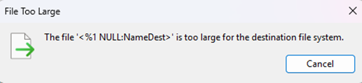

One of my personal shares has stopped allowing saves or creation of folders. It gives the following message when trying to create a folder anywhere on the share:
I can Create a new Share with a different name and move all files over physically & things work just fine.
I can RENAME the original Share and things work just fine.
But if I rename a new Share to be the same "old" name, I again get the listed error. I feel it is a corruption linked to the original Share and some unresolved issue, but I am not versed enough in Linux to figure out what to do.

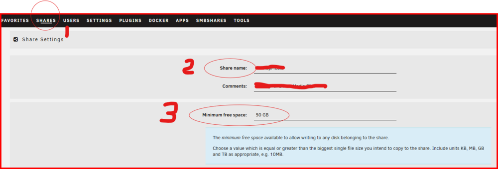

Try going here:
Set that #3 value to a reasonable value based on the largest file you will be transferring to that share.
Ok, it was set to 42 GB, and I lowered it to 20 GB. Same result.
I then raised it to 50 GB and again same result.

EDIT: One more thing. What is sending this file to Unraid? (I don't recognize the format of that error message...)

Yes Chris_Share was a rename. The error is from Windows when the share was Chris and I was attempting to create a new folder in file explorer.
