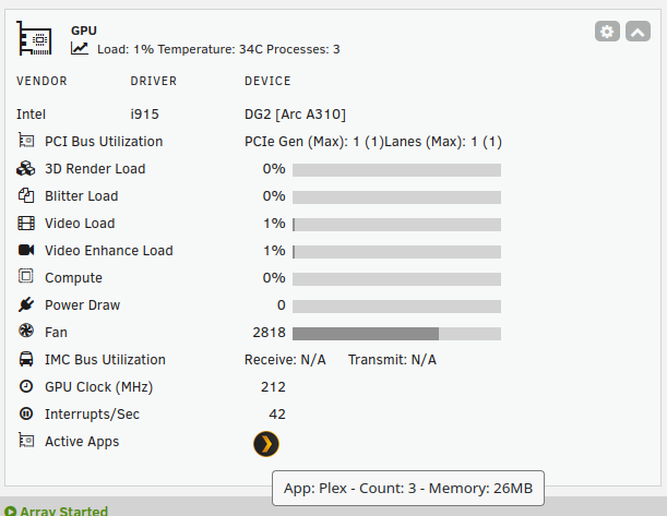

I can confirm the GPU reports incorrectly the link speed. My A310 always shows x1 as well regardless of what it's doing.

I ran 3 simultaneous transcodes using my A310 and the i915 drivers with plex 1.43.1.10611 for about 20 minutes and zero crashes or unraid going unresponsive, whatever your issue is I do not suspect it is caused by plex.
Ive also been using Xe drivers as well, no issues.
I tend to agree that it would be odd that Plex is the issue, however, all of my evidence is pointing to that at the moment. When you say you're using the i915 and xe drivers what do you mean? You're using both?
@cjlmediasolutions Yes I was running the Xe drivers and switched back to i915 to test this specifically.
