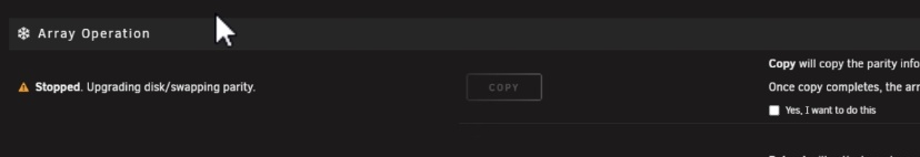

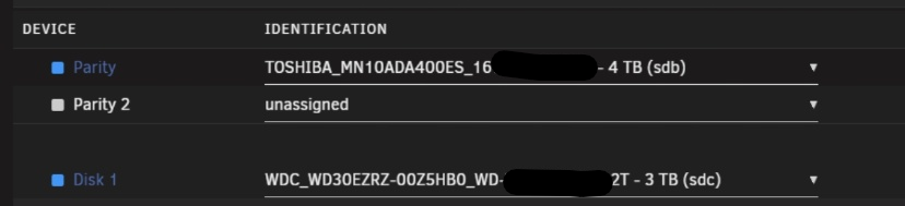

I can tell you that copy finished seemingly successfully (see photo),
...this left the array in a stopped state. No errors.
Also no way to start the array after that:
  • Neither "as is" (with new parity copy and old parity disk being in data disk position assigned), to render the old parity as new data. There was no start button. Only a "copy" button still. I think it was clickable (like copy never happened - in contrast with having that status message above and me actually SEEING the copy happening until almost 20% -then had to leave it continue unattended).
    image.png\
    (above 2 screenshots are AFTER copy seemingly finished)
  • Or by unassigning old parity and stay with copied parity and no data disk so that data are "emulated".
...so I was forced to reboot, as there was nothing to do with the above setup. And the rest is as I describe in my previous message.

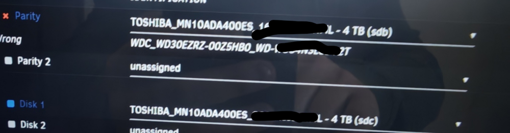

I tried to replace the old parity disk (that was in a data possition as "parity swap" dictates) with new fresh data disk. No go.
As you can see (the below is just before I eventually tried "new config") it ignored the copy it (seemingly) performed over several hours that finished WITHOUT error and shows parity as "wrong". Somehow it expected the old parity in place!!!
...after this I was forced to make "new config", that as I said, demanded I rebuild my (copied - valid?) parity using the data from the... empty new data disk. Of course I didn't allow that and reverted to both OLD disks (old parity, old data, accept parity as valid). So now they are back to square one.
After the copy is finished successfully, it will show the "start data rebuild" option, and you cannot click on anything else.
If it's not showing that, it suggests the copy is failing. You can try again, and if after the copy finishes you don't see the rebuild option, post the diags.

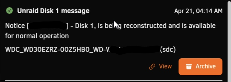

6 hours ago, JorgeB said:
Yes, that should also work.
So, parity in a dual disk setup is really a mirror?
Yep, you can just assign old parity as disk1 after a new config.
