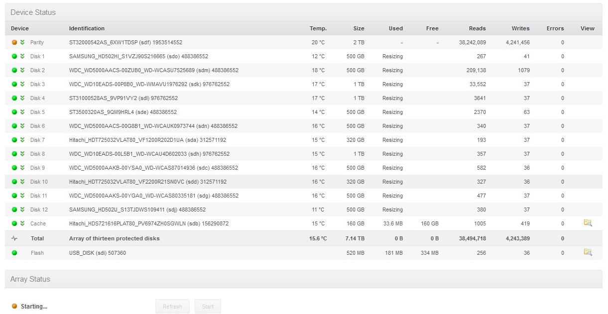

However when I tried assigning the drive as parity, the server has hung again.  I've attached a screenshot of what i saw just before the hang.
Has anyone got any ideas what could be causing this?  Could it be related to this drive being an advanced format drive, whereas all my others are not?  My old hardware might not like this drive?? (Although pre-clear worked ok).
Not sure how to debug this as I can't get a syslog when it keeps hanging.
