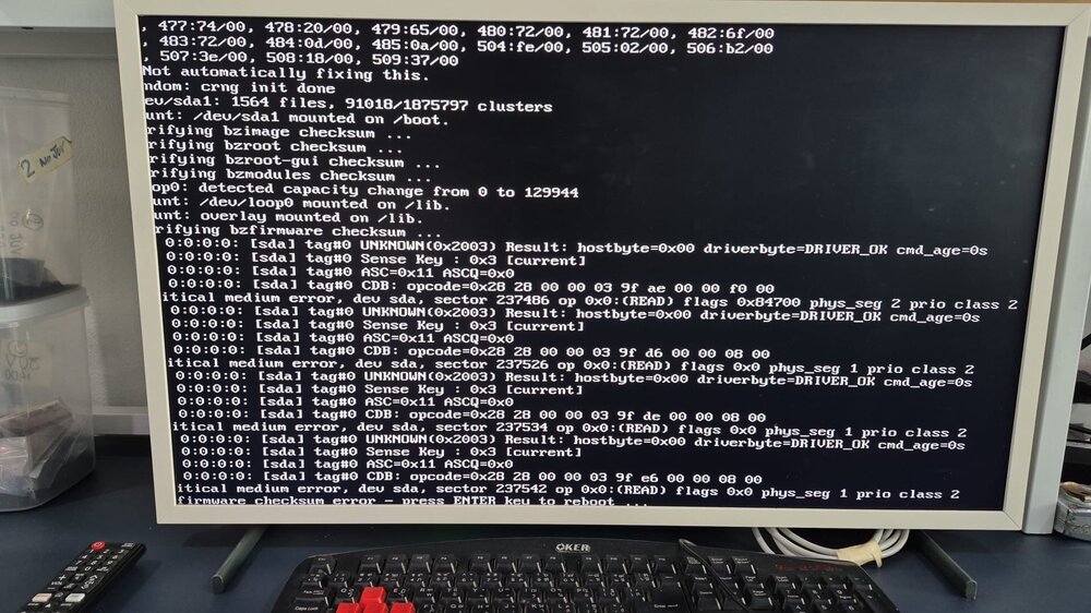

I have an issue with my unraid server after a power failure and I get the firmware checksum error on boot up. I have checked the usb is OK using windows chkdsk and I have changed out the usb stick for a new one but the same problem occurs. What can I do?
Cheers
Maurice
That looks like a flash drive problem. Does a different flash drive using a stock install boot? No key needed, just for testing.

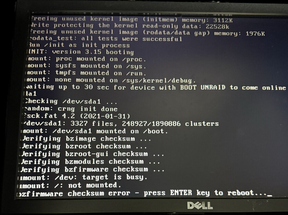

@JorgeB I have the same problem today see picture below, so I should test a new USB first with stock standard if that is ok what would be next move to get my Unraid server back online ?unraiderror.jpg
sure
@JorgeB it booted correctly with replacement USB so that's good what's next step to get the server back ? Or can you point me in the right direction Cheers Justintas
As a first step I would suggest is recreating the old flash drive, first backup the current one, then recreate it using the USB tool, confirm the server still boots with that flash drive and a stock install, and if yes, restore only the /config folder from the backup overwriting any existing files.
