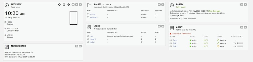

I bought a HP EliteDesk 800 to try unraid on. I had two spare 1TB 3.5inch drives which i set for my main storage. I also bought a 1TB 2.5inch to act as parity. I do note that one of the drives is showing a SMART error, but as im only evaluating Im not too bothered as the files are backed up elsewhere. Should i be concerened long term with this?

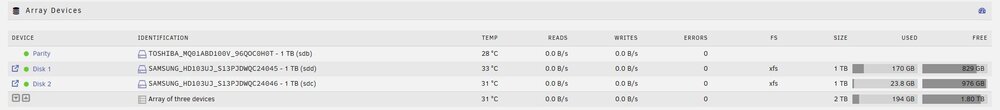

However, im confused by the information im seeing relating to the array devices -
  1. Why is there not an equal split of used space on the array?
  2. If disk1 dies, can i expect to fully recover all the information if I install a replacement disk? I just cant get my head around the unequal split of data across the drives.
  3. Why is there no used space on the parity drive?
  4. How much storage space do i actually have? I was expecting 1TB but it would appear i have 2TB?

  1. This is dependent on which allocation method you have set in your share settings. It’s probably “high water” which will determine how much space is available on each drive and write to that drive until half the available space is used (minimizes unnecessary spin-up of other drives). You can go to the share settings page for one of your shares and click the question mark to see a description of all settings.
  2. With one parity disk you have protection for one failed disk. At the risk of over simplifying, the parity disk stores the sum of each bit for all data drives (odd or even). If a disk fails the system will check sum of each bit for the remaining disks and calculate whether the missing bit was a one or zero. This allows the missing drive to be rebuilt one bit at a time.
  3. All space is always used on parity.
  4. Unraid is not raid. The total storage space will be the sum of all data drives.

The allocation method was indeed "High water". I'm just finding my way around the system, so kept everything with the default settings. At the moment it works fine, but 'll look into the different options later.
Ah, so i was getting confused comparing UnRaid to Raid.

32 Reported_Uncorrect is the reason for 👎 . Might be OK for now
Click on disk2 to get to its page, then do extended self-test.
I did the extended self-test which returned "Last SMART test result: Completed without error"
Dashboard array section still shows "Array has 1 SMART error. " but i'll live with that for now, whilst i explore UnRaid.
If you click on the orange thumbs down icon and select the Acknowledge menu option then Unraid will stop alerting unless the value changes.
