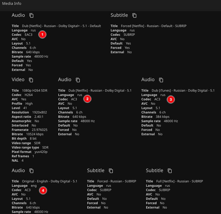

Looking through the dry-run logs, I assume the audio-tracks and subtitle-tracks indexes are the items to keep after processing?
So in this example it would drop 3 audio tracks and only keep the current track 4.
Checking the media info in Jellyfin seem to follow the same order, does anyone know if this a reliable way to quickly check which track(s) will be kept?
