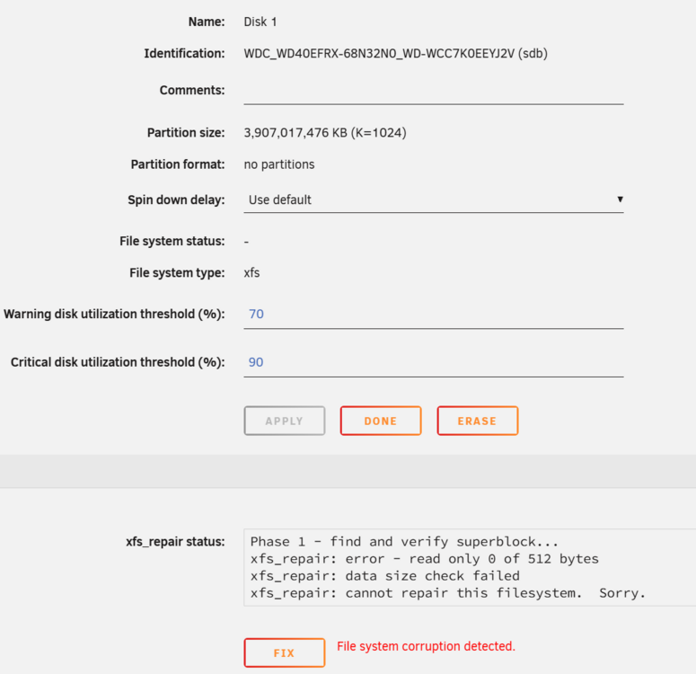

In prep for disk upgrades, I figured it best to update "everything". Watched upgrade vid from AlienTech42 for stepwise prep. I backed up the boot drive, checked SMART on all drives (no errors), updated plugins and dockers, stopped the array, and ran update from 7.0.3 to 7.3.1. After update and reboot, server didn't come back up. Went to office and hardware rebooted, and knew there were problems when I heard an internal drive (the cache) trying to boot. Hard rebooted again and went into CMOS and found evidently CMOS battery was dead and boot config had been dropped so that it was trying to boot from cache drive rather than USB. Replaced CMOS battery, fixed boot order, and booted server back up. Booted up fine this time, but array did not start, pointing at my Disk 1 and saying the "replacement" drive was too small, though it was the same drive. Cache drive also had a error. Started array in maintenance mode, cache fixed seemingly without issue. However, Disk 1 would not fix with xfs_repair (watched SpaceInvaderOne fix video; it didn't directly address array disks, but got the gist that needed to r un repair tool). Tried running xfs_repair from cmd, same issue (no superblock found). Went ahead and synced parity, then checked parity, all without issue. But Disk 1 still shows unmountable. snips attached, again xfs_repair says it can't repair the file system. Disk 1 SMART short test comes back no errors.

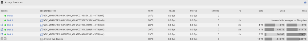

Also noted after reboot back in one last time to see if by chance it would fix that my dockers are gone. I only had Plex, filebot, and Jellyfin, but all are gone. I'm assuming it is likely an issue with how my appdata is set up; including a snip of drives info.

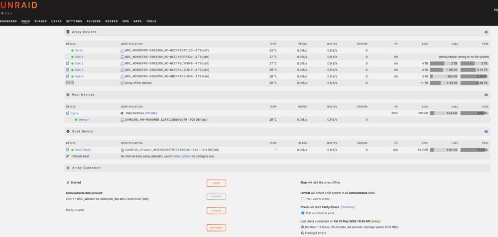

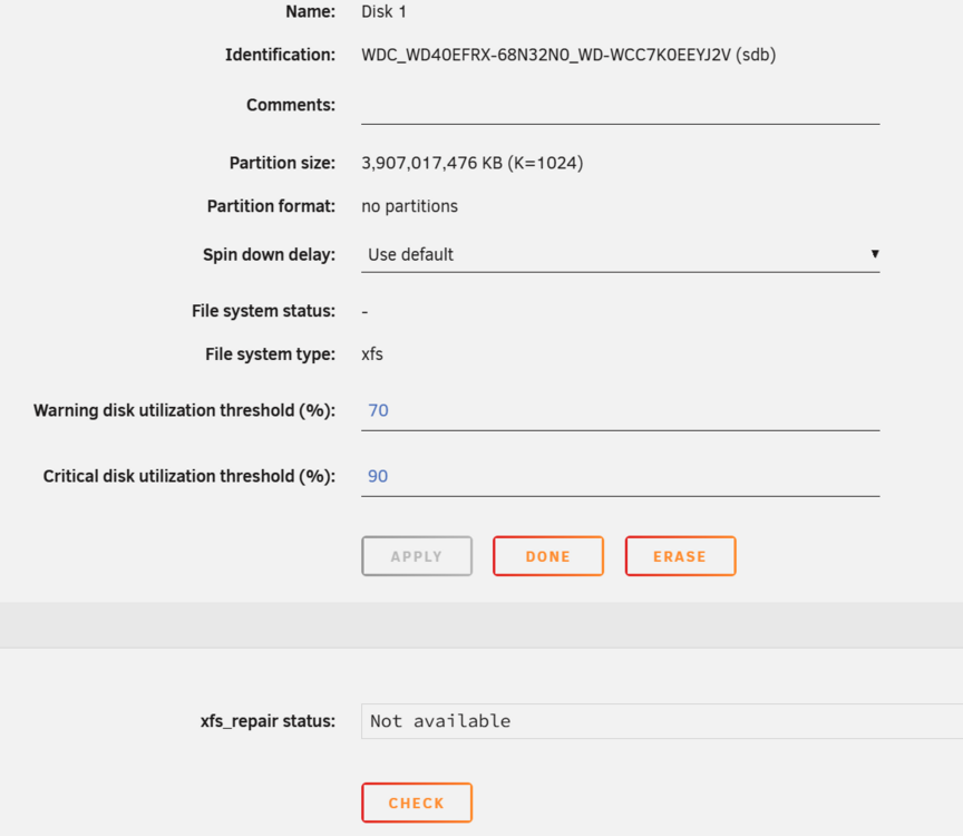

Data in shares appears to be intact, though admittedly I did not get out to check every file directly. The server was running 15TB (4+4+4+3) plus single parity and was not yet at half capacity.
