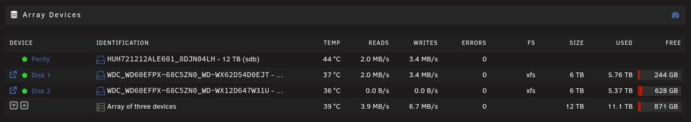

As it currently stands I have an array with my parity disk as a 12tb drive and data disks are two 6tb drives. I recently procured another 12tb drive, how can I change one of the 6tb drives to parity so I can add the new drive to the array and have 18tb of storage?

If I'm understanding what you are asking correctly, that's not possible; parity drives must be the same size or larger than any individual data drives.
@hyphonetics
There are 2 possibilities to increase available storage that you might want to consider:
  • Add the new 12TB drive replacing a 6TB drive increasing the total available space by 6TB to give 18TB.
  • Add the new 12TB drive as an additional data drive (i.e.disk3) increasing the total available space by 12TB to give 24TB.

I stopped my array, changed a data disk from a 6tb to a 12tb, so now the data array is 6tb & 12tb, data is currently rebuilding.
After that is done, the now unallocated 6tb disk will get added back as a parity drive.
Thanks for the help!

Parity must be equal to or larger than ur biggest data disk , as you have added a 12tb data disk, parity disk must be 12tb or larger so you will be blocked from adding the 6tb as parity , you could however add it as a data disk
as already explained
