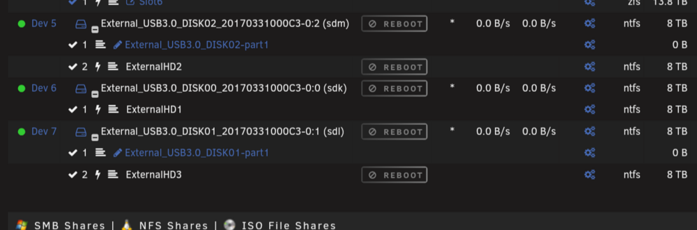

I have my UNRAID (7.2.7) NAS on a UPS and have a DAS connected to it. When I power down the DAS, Unraid won't auto-mount or let me mount the drives unless I reboot Unraid. Is there some setting/script that I can use to have UNRAID ignore the lost connection and just remount the drives when the power turns on again? Yeah, I can connect the DAS to the UPS and not shut it down, but I need to move it around from time to time to other devices when I'm moving large amounts of data since transfers are faster on a direct connection.

These were external drives that I schucked and put into a DAS. I'd love to reformat them but current HD prices have kept me from getting another drive to move the data to and perform a format.
I found a manual fix that would allow me to re-mount them without rebooting Unraid. Sharing in case anyone runs into this issue down the road. We should have the option to be able to hot swap drives not part of an array or pool without having to unmount or reboot Unraid.
Open terminal
mount | grep disks
Find the unmounted drives, copy their path and names
umount -l /mnt/disks/<drive name>
Now you can mount as normal in unassigned devices.
