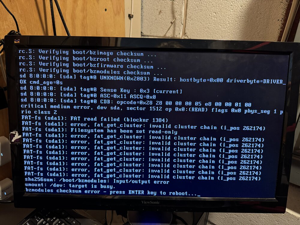

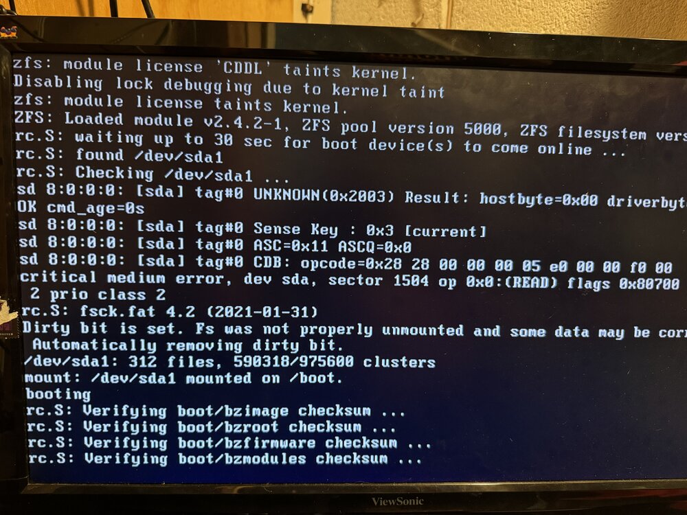

Errors on boot up causing server to lock up
This has been happening for about a week. For two days, I couldn't get the server to boot at all. I switched USB ports and the server is now up, but I'm still seeing the same errors.
Running Unraid 7.3.1, diagnostics file attached.
server-pc-diagnostics-20260702-0952.zip
Solved by JorgeB
That looks like a bad flash drive, you can try recreating it first, if the issues persist, best to replace it.
That's what I thought, but figured I'd ask just in case. Thanks.
Always worth trying rewriting the contents (especially the bz* type files) as that surprisingly frequently seems to help.
Unfortunately, I can no longer access the drive. We lost power the other day, so I had to shut down the server and now I can't get it back up. Windows will not recognize the drive. Any ideas on how to pull the config file so I can move it to the new drive?
Check if you can see the drive as a hardware device on Windows in disk management.
If you can't then try different USB ports, also different machines if available (Windows, Mac, Linux).
If the drive gets recognized then the controller is functional and files are potentially recoverable via software recovery tools.
If it doesn't then it's bricked.
