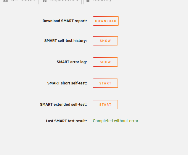

So, we are done, and this is the status update )
image.pngST20000NM007D-3DJ103_ZVT5ZA0F-20260714-1519.txt
From what I can tell, its all good? )
I have NOT changed the power to the disk yet, but I will if needed for sure! :) The sata cable for the drive was changed before the test was made.

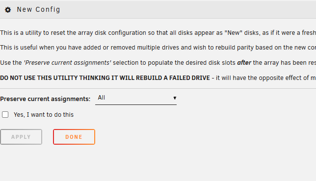

If I can do a rebuild, can I just click this:
Just figure since I am not changing anything, that I can choose to preserve the current assignments? )

No. If you use New Config then you can no longer do a rebuild.

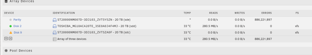

Follow the guide - and now this is what I got (
Edited by Cololate
That shows errors on parity; new diags please. (and cancel the rebuild if it didn't abort by itself)
