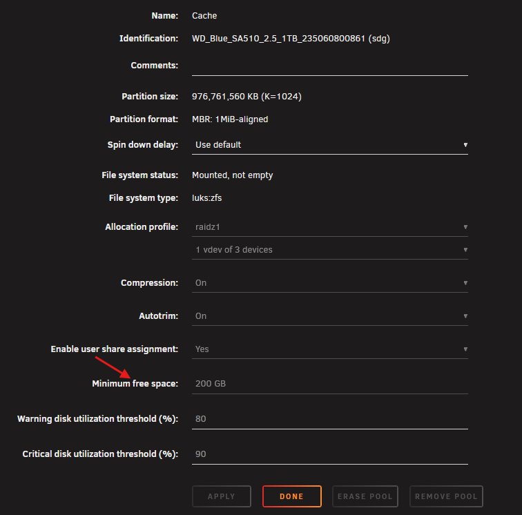

5 minutes ago, MowMdown said:
Your cache drive is full and likely caused a host of problems since data could not write to it and also might want to check the filesystem of disk 18.
I saw those error messages too, but have a minimum set and it never got below 20GB
webGUI of array disks
You have a minimum cache floor of "0" per your pool settings.

Weird, as I thought I had changed it. Perhaps I only changed it within sabNZBD. Thanks

Note this setting is separate from each share's own minimum free space setting
Edited by MowMdown
got it. thx. Guesing I need to stop the array to change cache minimum? As it is greyed out currently.
Yes

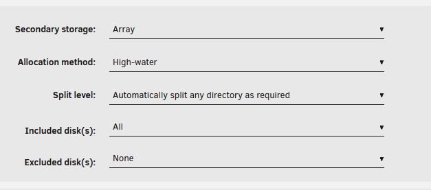

The only thing that looks sus is the split level on the M share, make sure its also set to something, the config shows it as blank
I am not familiar with this setting and am not very good with unRAID in general. Any recommendations? I don't have deep folder hierarchy but understand that I should likely have it set. It looks to be set to "Automatic"
Thanks for your help!
Edited by wdpaynter
That should be fine. Split level just tries to keep files together on the same disk if they belong together (are in the same folder). Highwater allocation often has the same result, where files that are written at the same time likely will end up on the same disk. The only penalty for files that belong together ending up on different disks is a delay when spinning up another disk. And since split level takes precedence over allocatiion and Minimum free, there can be some downside to making it keep files on the same disk, where it might try to put files on the same disk even if they won't fit.

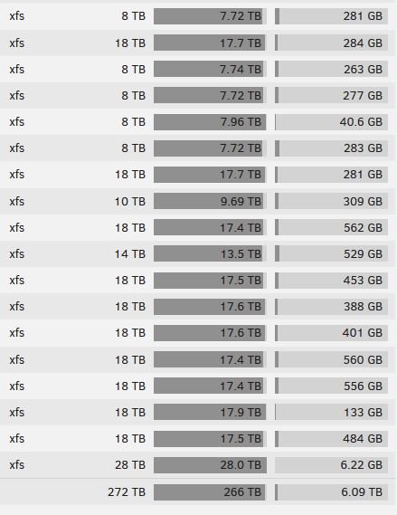

One last question. At some point disk18 was incorrectly reporting its free space and it looks to be corrected. It only has 6GB of free space, which seems really low. Should I move files to another disk manually (Krusader)? Or leave it be? Pic of drives attached. Thx
It's a good idea to keep some space free on each drive in case filesystem repair needs some space to work in. Disk5 also doesn't have much free space.
Should I move files to other drives manually?
You don't need krusader, and if krusader is configured to allow you to access individual disks, you must be sure you don't mix disks and user shares when moving/copying.
Built-in File Manager won't let you make that mistake.
I was just going to move them and then let unRAID do its thing moving forward (not manually move). Not sure excatly how this happened in the first place, as I have it set to a 97.7GB minimum
I did first one using Krusader and second using File Manager. Will use File Manager moving forward. Thx! Maybe i moved a share to a disk previously or vice versa that screwed things up to begin with?
