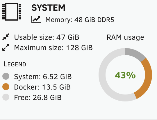

The fix things said to post this here, overall the RAM usage doesn't look wild to me. Which of these log files helps you help me? I started perusing, but didn't find much of anything useful in the few files I checked.
Most memory intensive application is frigate. Almost all my docker containers are restricted to the RAM amount I specify, except some newer containers like paperless-ngx and redis. Frigate is allowed 20gb and is currently in at 16gb. Most of my cameras are running higher detection resolutions (and I have many) so this is expected, not misconfigured.Screenshot 2026-07-20 at 10.10.23.pngScreenshot 2026-07-20 at 10.11.45.png

What likely happened is there was many docker containers using RAM in high quantities which resulted in 99% RAM use on the system when that error was generated.

And also, does setting RAM limits not prevent it from consuming the full memory on the system? Some of my containers are only allowed 512mb, I'm pretty intense with the limiting.
The OOM event was apparently caused by a Docker container that had a hard memory limit of 768 MB, and it reached it exactly, it wasn't a system-wide out-of-memory event.
Looks like this one: docker/b7215cfc67841485fb9a58cbb88ebde431e9206868bcc0364923718121f566c8

Every time one of your containers hits the limit it will be culled and logged, which FCP will detect and report every single time FCP scans the log, so you will need to reboot every time to clear the log.
You can use the advanced tab to match the first 12 digits of the container ID'd in the log ie:
b7215cfc6784

Just to be clear, what ran out of RAM before was just that container, not the server.
