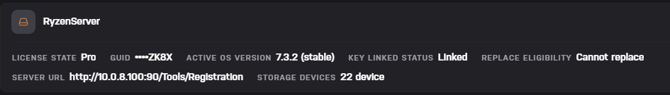

August 11Aug 11 Hi, 🙂I've been using an unRAID setup for many years on a Ryzen 1600AF, an MSI B450 motherboard, and 64GB of RAM.This server is my network hub and handles everything; it has a lot of things running and is becoming too small for me.But the license is tied to the motherboard.I bought an ASUS X570 and a 5950X so I can continue using my 64GB of RAM, and also because it has more PCIe lanes and, above all, because it's PCIe 4.0.Can I transfer my license to this new motherboard?Is it not possible according to what I've read?Thank you so much
August 11Aug 11 Community Expert Solution You will need to open a support ticket or email unraid support for them to move your license to the new TPM since you are ineligible.
August 11Aug 11 Author 20 minutes ago, MowMdown said:You will need to open a support ticket or email unraid support for them to move your license to the new TPM since you are ineligible.Well, that's a shame... 🤨I didn't want to use the TPM license, but when I updated unraid to the version that allowed internal booting, it wouldn't boot from that USB drive. This is because I use an SSD in a USB 3.0 enclosure as a flash drive, and the new version of unraid doesn't seem to like my SSD + USB enclosure setup after so many years of it working perfectly.Anyway, I have two PRO licenses, one of which is still linked to another USB drive. So, by restoring a backup from the current server to this USB drive and using the second license linked to it, I can continue working on the X570+5950x (I've tested it).But this shouldn't be the case. I don't know how long it takes to transfer the license to the new motherboard, but if I transfer all the drives to the new computer and only have one license, and it takes several days to transfer it, I'll have a problem at home.I'm going to contact support and have them remove the license from the B450 and transfer it to the new motherboard or another compatible USB drive, because I'm going to sell it.Thank you very much.
August 12Aug 12 Community Expert Note that there's currently a bug with the account app where it always shows "cannot replace," so it may be worth trying it yourself first.

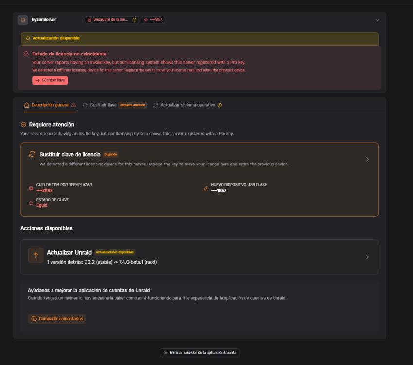

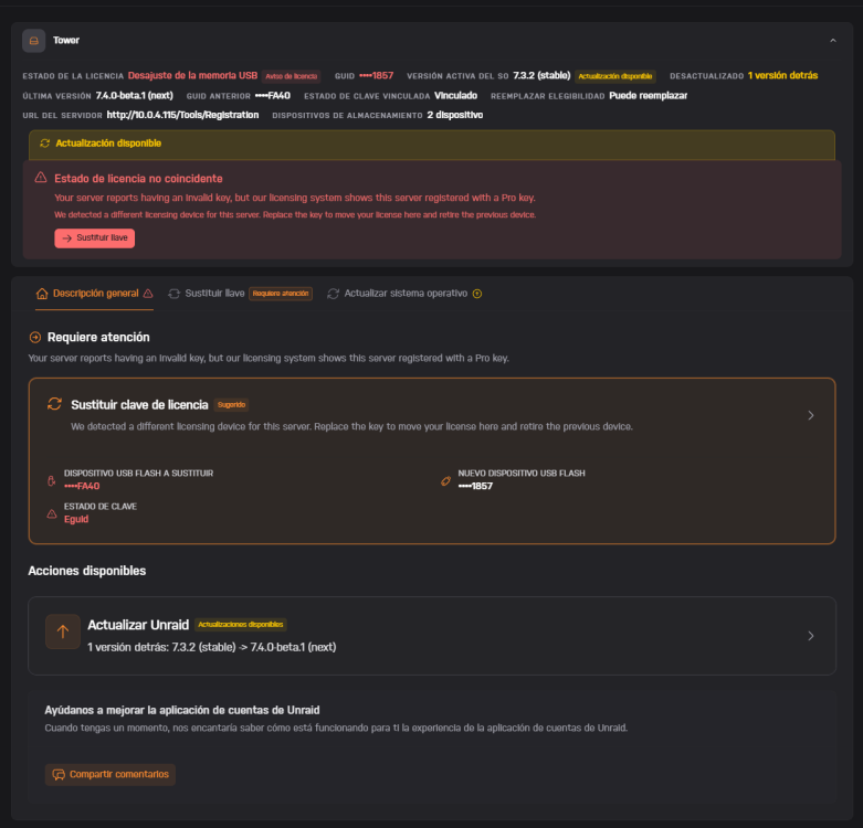

Friday at 07:15 PM4 days Author I'm picking this up again...Because I wanted to transfer my second unraid PRO license, which I use for testing, to another USB drive.And I can't find a way to do it. Does the system force me to switch to TPM? Is switching to TPM now mandatory?. (I absolutely refuse; this license is constantly being tested with different hardware.) 🤨
Friday at 09:02 PM3 days Author 7 minutes ago, MowMdown said:are you currently booted from the replacement USB?Yes, of course, I have several USB drives, I've tried with several and it's always the same, I never see an option to transfer to another USB drive, only TPM.EDIT:Disabling TPM 2.0 on the motherboard was enough to make the option to switch to USB appear.I don't think this should be necessary. By default, if UnRAID detects TPM as active, it doesn't show any USB devices at all to change the license from one USB drive to another.This has given me an idea...Perhaps if I boot my production server with TPM disabled, it might allow me to switch back from TPM to a USB drive. 🤔Although I didn't plan on changing the motherboard in the production server for a long time, I almost prefer having it on USB; if the motherboard fails, I just install the spare and it's up and running quickly. Edited Friday at 09:22 PM3 days by PoMpIs
Saturday at 06:44 AM3 days Community Expert 9 hours ago, PoMpIs said:Disabling TPM 2.0 on the motherboard was enough to make the option to switch to USB appear.Yep, currently this is the way.

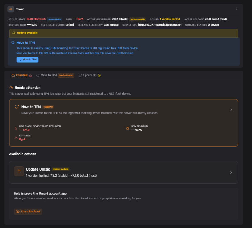

Saturday at 07:12 PM3 days Author 12 hours ago, JorgeB said:Yep, currently this is the way.Well, it's been confirmed... if I remove the TPM on my production server, which has the license transferred to the TPM, I can then transfer it back to a USB drive.So, the message from my unraid account that I'm not allowed to transfer that license is incorrect.
Sunday at 08:04 AM2 days Community Expert 12 hours ago, PoMpIs said:So, the message from my unraid account that I'm not allowed to transfer that license is incorrect.That is an unrelated bug, it shows for everyone, even when the license can be transferred by the user.
