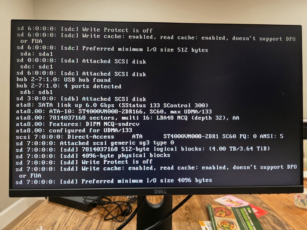

I opened up my PC case and took out two unused drives and added in two new drives which I intend to use as (mirrored) cache. Unraid would not boot, so I took out the two new SDDs. At this point my system should be identical to what it was before, with the exception of the removal of those two unused drives. Unraid will no longer boot. I've tried with and without the GUI and with and without Safe Mode. It gets as far as "sd 7:0:0:0: [sdd] Preferred minimum I/O size 4096 bytes" and then appears to just hang. I really don't know how to debug this. I made a bootable Ubuntu USB and booted that up; the hardware all appears to be fine. Ubuntu found my two 4TB Array drives and my two 256MB Cache drives.

Interesting idea, Jorge. What I learned first of all is that the Unraid USB Creator doesn't make the USB drive bootable. <grrr> After wasting an hour or more trying four different USB drives and three different ports on my PC, I finally stumbled upon "make_bootable.bat". Now that I'm past that hurdle, I see that my original USB will boot just fine with the new config folder, but with my saved config folder the boot continues to hang at the exact same spot. I guess that means there is some setting in there that's completely tripping up Unraid. It also means that as a last resort I can rebuild Tower from scratch, since my data are all on the rotating disk. But, of course, I'd really like to just get my original config working.
