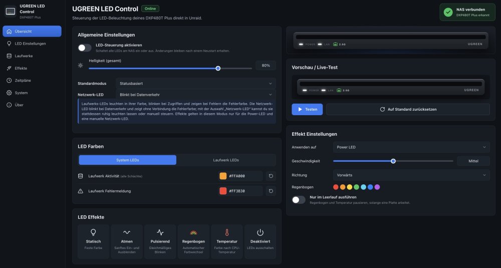

Thanks for the idea, lsaranto – the link-speed colour is in (version 0.22.1, Plugins → Check for Updates).
Where: LED settings → card “Network LED” → “Network LED by link speed”. It gives each speed its own colour (10M, 100M, 1G, 2.5G, 5G, 10G), all changeable, and it’s off by default.
On top of that, the case picture and the dashboard tile now draw the network ports next to the LAN LED as RJ45 sockets: a connected port in the colour of its speed with “2.5G”, “10G” and so on, and a port without a link as a dimmed socket with a cross and the speed it supports.
@ivolution – to your question: a real use is a cable or port that only negotiates 1G instead of 2.5G or 10G. That often goes unnoticed for years, and a different LED colour shows it at a glance.

11 hours ago, datarepos said:
here ist my terminal output:
# /usr/local/emhttp/plugins/ugreen-led-control/backend/ugreen-led-ctl smbus
/usr/local/emhttp/plugins/ugreen-led-control/backend/ugreen-led-i2c probe
i2cdetect -l
i2cdetect -y $(i2cdetect -l | grep "SMBus I801" | grep -Po "i2c-\K\d+")
SMBus adapter: /sys/bus/i2c/devices/i2c-0/name:SMBus I801 adapter at 0000:00:1f.4
"address": "0x3a",
"bus": "/dev/i2c-0",
"leds": null
ERROR: no LED answered on /dev/i2c-0
-bash: i2cdetect: command not found
The script ist configured to run at first start of array. But the blinking also does not stop when i run the script manually after everything is started. A screenshit from the plugin is attached.
Many thanks for you support! Best datarepos
Thanks again, datarepos.
I looked at ich777’s plugin: your script is exactly what he runs for the DXP480T Plus (the dxp480t_static function), and it needs the i2c-tools package that his plugin shipped. Since that plugin is deprecated and you’ve removed it, i2cset is gone, which is why the LED keeps blinking.
I’ll add native support for the DXP480T to my plugin: it will set the power LED to static white by itself, without any script or extra packages. I’ll ask you to test it once it’s ready, since I don’t have this model.
New Update 0.23.0 sets the DXP480T Plus power LED to static white by itself at boot (no script or i2c-tools needed; it uses the same register writes as ich777’s driver).
Please update, remove your startup script, reboot and tell me if the LED stops blinking.
If it doesn’t, please run
/usr/local/emhttp/plugins/ugreen-led-control/backend/ugreen-led-i2c dxp480t white; echo $?
and
/usr/local/emhttp/plugins/ugreen-led-control/backend/ugreen-led-i2c scan all
and paste the output.
Hi Schubi05,
thank you your plugin!
I just tested it on a DXP480T Plus (after uninstalling ich777's first + reboot) and the LED is staying white as intended. 🙂
Edited by Squirt6346
Thanks a lot for testing, @Squirt6346, that’s exactly what I hoped for, as I can’t try this model myself. Good to know the DXP480T Plus works without any script or extra packages.
@datarepos, same for you: update to 0.23.0, remove your startup script and reboot. If the LED still blinks, the two commands above would show why.
and
Hi Schubi05,
Thank you for this quick update.
After disabling the script and installing version 0.23.0, the LED stays on continuously after a reboot and no longer flashes. The color is now orange; previously, it was always white.
Best
datarepos
