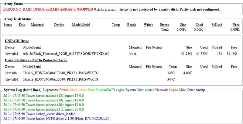

Precleared 1 disk, unMENU/Main shows 2?
I've just precleared one 4TB disk, but if i go into unMenu's main screen, it shows 2 disks?
/dev/sdb
/dev/sdb1
Is this normal?

It shows the disk and also the entry for the first partition on the disk. There is nothing unusual.  The trailing "1" on the disk name indicates it is the name for the first partition on the disk.

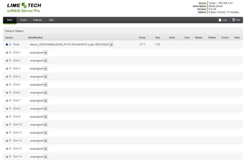

I've assigned it as parity disk, but still no format button... is there a screenshot to show where this should be?
Or should i reboot for changes to take effect?

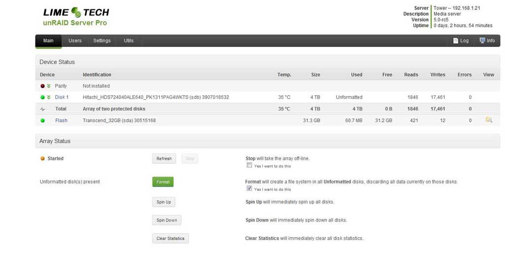

You haven't started the array. Format shows after that...
Though i'm not sure why you are adding a parity drive with 0 data disk. I'd imagine unRAID wouldn't even allow you to start the array with just a parity drive.
I'm just in a testing- and discovery period ;) i bought one disk just to get an idea about what unRAID does and how it works, to see if it's something i want to go with. I now understand that for the format procedure, you need to have an actual array of multiple disks, i was under the impression that you could just format a single disk, like in any other OS, but 'formatting' in the unRAID context is closely coupled to formatting the actual array rather then one disk as it seems.
Guess it's time to get some more disks then ;)
If you assign the disk as a data disk then the Format button will appear after the array is started.
Yep! Found it :)

Looks like the "Simplefeatures" add-on you've installed has a bug.  It says you have a protected array of two drives.
You are not protected (since you've not installed a parity drive yet), and only have one data disk installed.  It is not affecting the array, it is a reporting display bug of the alternate skin you installed.  You should report that to its author.
