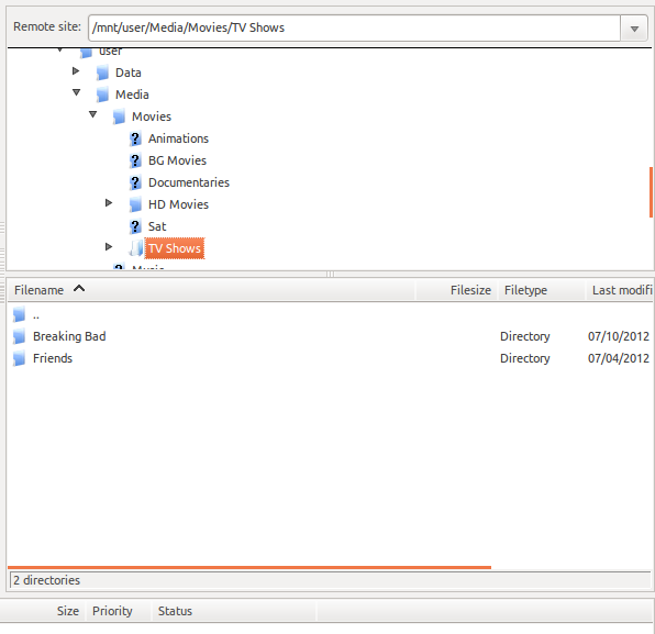

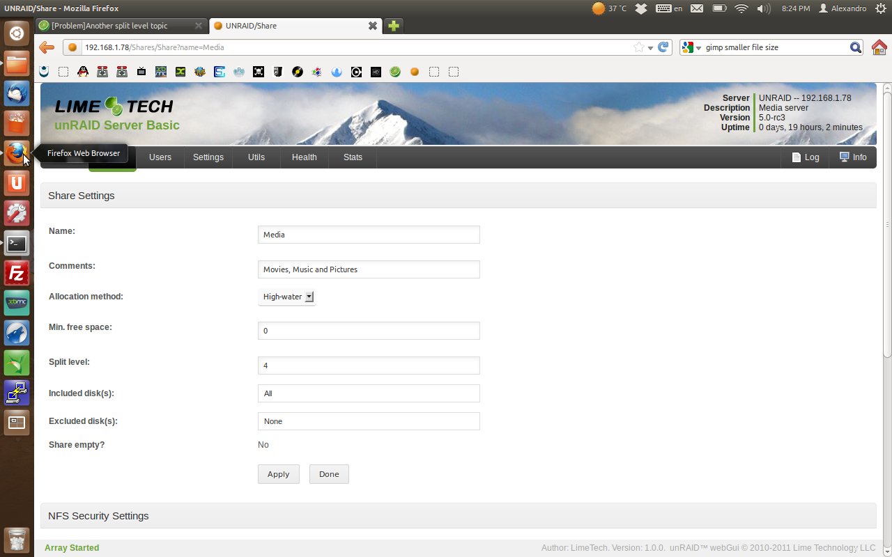

July 14, 201214 yr Is the directory structure like this? Usershare is the share that appears over the network? Media is a directory inside Usershare, Movies is inside Media and HD Movies is inside Movies? If so, that is 4 directories deep so the HD Movies can not split with the split level set to 3. Level 4 should have worked for movies but each complete TV series has to remain on a single disk. Level 5 is too high for movies but it would allow a new season of a TV series to go to a new disk. Care to share the complete Usershare settings or is that a secret?
July 14, 201214 yr Author I am sorry for the delay. Of course my directory structure is not a secret. Please find it attached. Best regards and thanks for your efforts.

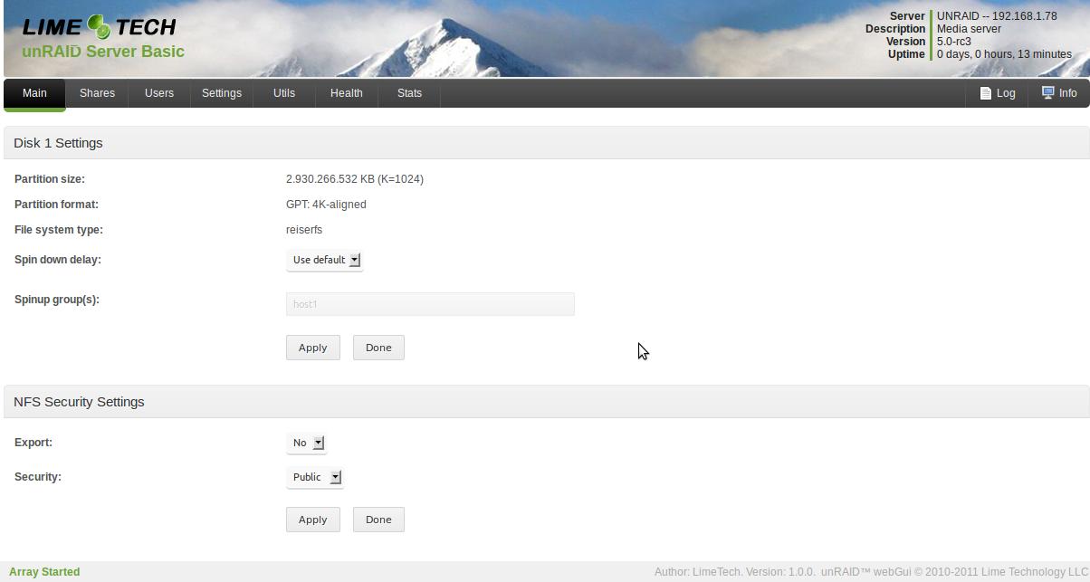

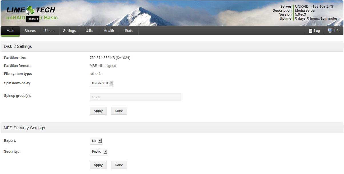

July 16, 201214 yr Author screen shot of your disk config screen please. Here are the screen shots for both disks.

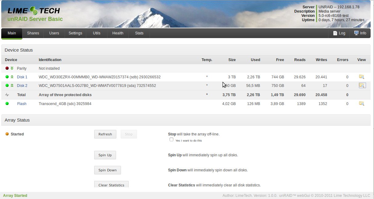

July 16, 201214 yr i think i know why. Disk1 = 3.0TB Disk2 = 750GB Using high water or most free would still be the 3.0TB drive. read up on allocation method in the unofficial wiki i linked earlier.
July 16, 201214 yr mr-hexen is correct. The high water allocation method attempts to step fill each disk so at the end of each step there is an equal free space left on each disk. http://lime-technology.com/wiki/index.php?title=Un-Official_UnRAID_Manual#High_Water

July 28, 201214 yr Author Thank you mr-hexen. Please kindly find attached the main screen capture. Due to the large file size i will attach the syslog in the next post.
