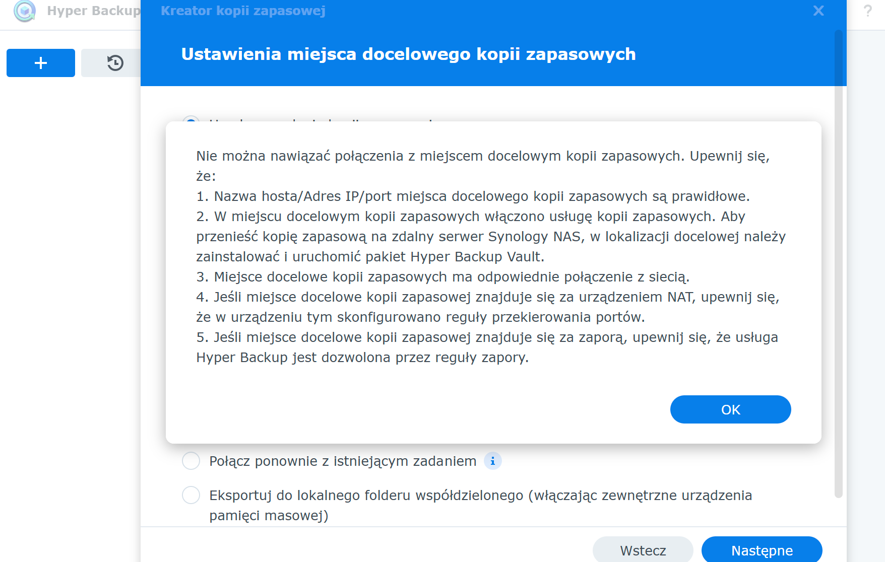

Hello,
late 2025 i done your guide Bung (twice) to be honest (https://forums.unraid.net/topic/2100-rsync/page/2/#findComment-819926), but synology is telling me that it can't connect to destination backup folder (like on picture). I'm on 7.1.4. I've checked already SMB Permissions (export on/off, private/secured/public) nothing helps. It sees both modules "backups" and "vmware" but when i press on one of them i get this message (same as if i click on next).
may i ask for assistance here ?

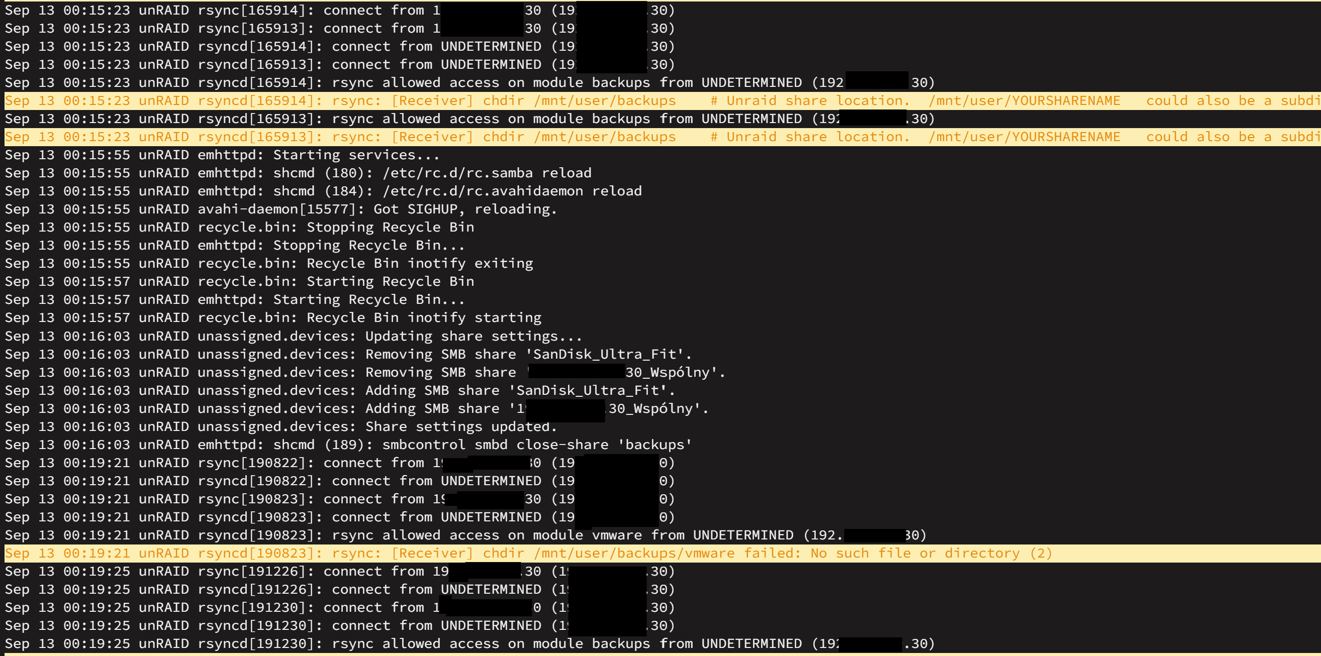

Here's my log:
