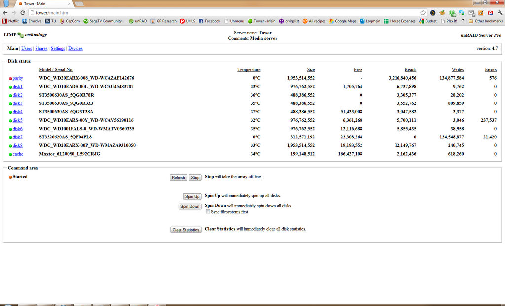

Need Help Disk Disabled at end of Parity Check
I had a parity drive failure in mid August.  I RMAed the drive, replaced it and then recalculated parity from my data drives.  All of this happened without any issues.  On 9/1/12 unmenu ran its scheduled monthly parity check.  I was getting hourly email notifications and noticed it was taking a long time...at one point I noticed that the parity check was going at 20 kb/s when I normally see 40,000 kb/s.  At the time I was getting 20kb/s I remotely connected to my unraid server and pulled up the main user interface.  At that time all drives were green, however I noticed disk5 had errors listed.  I was on vacation so I did not have direct access to the server.  Utimately the parity check finished however when it finished the parity drive was disabled and has the red dot next to it.  Attached is a screenshot.  I have a syslog however it is too large to attach.  However,  here is a link to the zipped syslog in my public dropbox folder:  https://dl.dropbox.com/u/10262611/syslog-2012-09-05.zip

1-Tower_-_Main_-_Google_Chrome_952012_12531_PM.jpg.d3038b13da9d276a909894164dc7cdef.jpg

So, how should I proceed.  The parity drive is disabled...and I wonder if it is still good.  Do I reboot the server and see if I can get smart reports?
Shutdown the server check all cables and power connections and attempt a restart.
I shutdown checked cables and restarted.  The weird thing is that the parity drive has a blue ball and says new parity disk installed.  I assume that I need to preserve whatever is on my parity drive so I am pretty sure I don't check the box about I'm sure I want to do this as it will recreate new parity.  What I assume I should do is unassign the parity drive and then see If I can start the array to gain access to the data drives.
What do you think?
Dan
What do you think?
Dan
but DO NOT write to the data disks, that would invalidate parity, even with it un-assigned, as it would no longer be in sync with the data.
You do need to deal with the failing disk, and for that to be re-constructed properly, you'll want valid parity.
On the 4.X series you can force the array to think parity is good and disk5 is bad with some command line commands.  I'm not as sure you can do the same on the 5.0 series...  Check with lime-technologies before trying, as you only get one shot.
Joe L.
I have unassigned the parity drive and started the array.  It looks like I am able to access all drives.  Is there a way to check and see if all of my data is OK?  Would a reiserfs check do any good?
I have spot checked several files and everything looks good.  I am also able to run smart reports now on the two drives that I could not before - they look fine to me, but I am no expert in reading these reports.

Those 2 look ok. Disk5 needs to be replaced. What version of unRAID?
Unraid Version 4.7.
I am confident my issue is with the two monoprice sil3132 sata cards.  I have had 4 drive failures in the last couple of months and they all have been connected to these controllers.....so I need to replace these two cards.  Any recommendations:  Supermicro AOC-SASLP 8mv I think is the obvious choice for 4.7.  I wonder how close we are to 5.0 final because if we were close maybe I should get a flashed m1050 card to get 6gb/s support.  My concern is make the transition to 5.0 while I am in the middle of these drive issues.  Any suggestions?
Dan
Use the "trust my parity procedure". It works on version 4.7. You can rebuild the failing disk.
The m1015's are stable in the latest beta 5.0-rc6-r8168-test2. I have two and they have been running fine.
Current Status:
I have ordered the Supermicro AOC saslp 8mv.  Once I receive it this is what I think I should do (please confirm or add suggestions).
1. Take Screenshot of main tower page for device assignments  and backup data from failing disk5.
2. Powerdown unraid, pull the two SIL3132 cards and install the new Supermicro AOC SASLP 8MV  (Question should my parity drive be connected to one of the motherboard sata ports or the supermicro add on card for best performance?)
3. Boot Unraid and assign disks
Now I am confused...I assume I have to go through the trust my array procedure:  http://lime-technology.com/wiki/index.php/Make_unRAID_Trust_the_Parity_Drive,_Avoid_Rebuilding_Parity_Unnecessarily
however this procedure says that you must keep the parity drive in the same slot...which I am confused about since I have to move it off the board it is installed on...data drives can be in different slots.    Also it says to only do that procedure if you do not have any missing disks, which I will since Disk 5 is bad.  Any suggestions would be greatly appreciated.
Dan
Physical slot isn't what they are saying, it's the disk list in unraid that matters. As far as rebuilding disk 5, that's what you use the command to tell unraid that parity is good and disk 5 is bad before you start the array.
