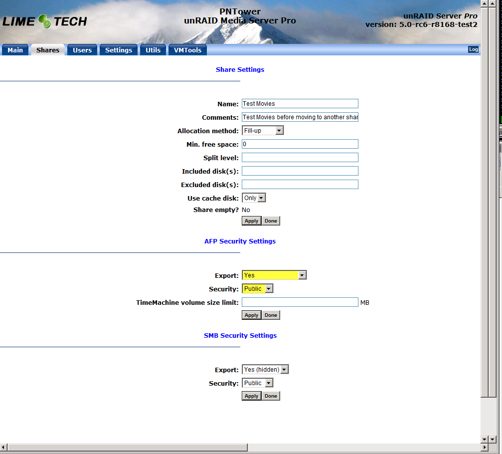

Bug / AFP Cache only share - running mover
Steps to reproduce:
Create a cache only share, and set to export via AFP as well as SMB. In my example the cache only AFP/SMB share is named "Test Movies"
Run mover you will receive rsync errors.
Versus a SMB cache only share which mover (rsync) skips the directory/folder altogether.
Attached: Screenshot of the AFP cache only share setting via web console. The same share '.cfg' file.
syslog snippet:

The screenshot does not match the description or the cfg. It appears the the log was taken when the share was not set to cache-only and the the min free space setting caused the failures.
You are correct (thanks), I was running various test to try to figure out if this was being caused by cache only share with AFP or not, and it is being caused by a cache only share with AFP. I accidently attached the wrong screenshoot and .cfg (I took several during my tests). I caught the wrong .cfg file earlier today and updated it, and you have now pointed out I had the wrong screenshot uploaded as well. I have just uploaded the correct one. This is very repeatable for me. Hope someone else can test as well.
It is very simple to set this up, as long as you have a cache drive and AFP enabled.
Just create a Cache Only share and enable AFP on it (or stop the array and copy that .cfg to your shares folder, restart the array) .
Have a terminal session open with a Tail and Hit the mover (you don't even have to have anything to move).
To be clear it is not being caused by the min free space, its a cache only share, mover should not be trying to move it at all, it should be getting skipped by mover just like the rest of the SMB cache only shares. (Plenty of free space on the cache drive)
