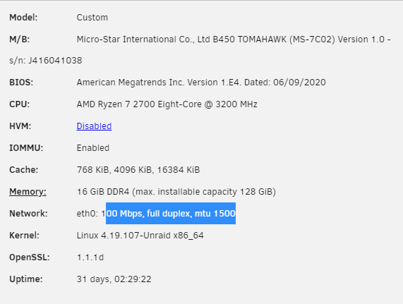

I just had a look at this and I am not sure how to read it, as when I do data tranfers I am only getting wound 10mb/s on a 1GB card.
so can someone please inform me if my card is set to 1GB and if not then how to set it. as I have a 1GB network and it would be nice to send data the Max speed.

Speed: 100Mb/s
But this shows it's only linking at 100Mbits, try a different cable or switch/port.
the cable I am using is Cat6 and the switch is a Netgear GS108 and it is plug into the 6th port.
looking it at it only has one light. so I have moved it to a different port and this also gives me one light, so it looks like a drive / nic settings issue.
if this is the case then is there a easy way to set the nic to 1GB ?

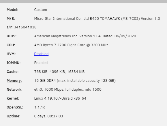

update: I just found the following command  ethtool -s eth0 speed 1000 duplex full autoneg off    which course my unraid to pull over.
but after a few reboots, I am happy to report that I now have the follow.
Forcing it may not work as intended, be sure to check with iperf.
