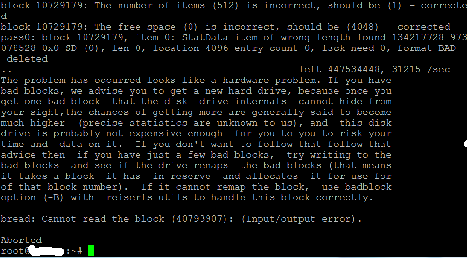

I had trouble with one of my hard drives and it was mounted as read only so I used the guide in the wiki to check the file system by running
reiserfsck --check /dev/md1
Which told me to run
reiserfsck --rebuild-tree /dev/md1
Then I got the following response
Loading on-disk bitmap .. ok, 487857249 blocks marked used
Skipping 23115 blocks (super block, journal, bitmaps) 487834134 blocks will be read
0%                                                   left 478809868, 24389 /sec
The problem has occurred looks like a hardware problem. If you have
bad blocks, we advise you to get a new hard drive, because once you
get one bad block  that the disk  drive internals  cannot hide from
your sight,the chances of getting more are generally said to become
much higher  (precise statistics are unknown to us), and  this disk
drive is probably not expensive enough  for you to you to risk your
time and  data on it.  If you don't want to follow that follow that
advice then  if you have just a few bad blocks,  try writing to the
bad blocks  and see if the drive remaps  the bad blocks (that means
it takes a block  it has  in reserve  and allocates  it for use for
of that block number).  If it cannot remap the block,  use badblock
option (-B) with  reiserfs utils to handle this block correctly.
bread: Cannot read the block (9114830): (Input/output error).
Aborted
root@Peanut:~# mount /dev/md1 /mnt/disk1
mount: /dev/md1: can't read superblock
Any ideas on how to rescue the data on the disk?

Okay tried that and got this -
reiserfsck --check started at Tue Dec 11 09:11:31 2012
Replaying journal: Done.
Reiserfs journal '/dev/md1' in blocks [18..8211]: 0 transactions replayed
Checking internal tree..
Bad root block 0. (--rebuild-tree did not complete)
Aborted
Should I try the --rebuild-tree option again or it stuffed  :-\?
Aborted
looks to me like you need to run
and let it complete.
Thanks for the continued help.
I tried that and it failed again see the attached screen shot.....
I am guessing the hard drive is not happy?
