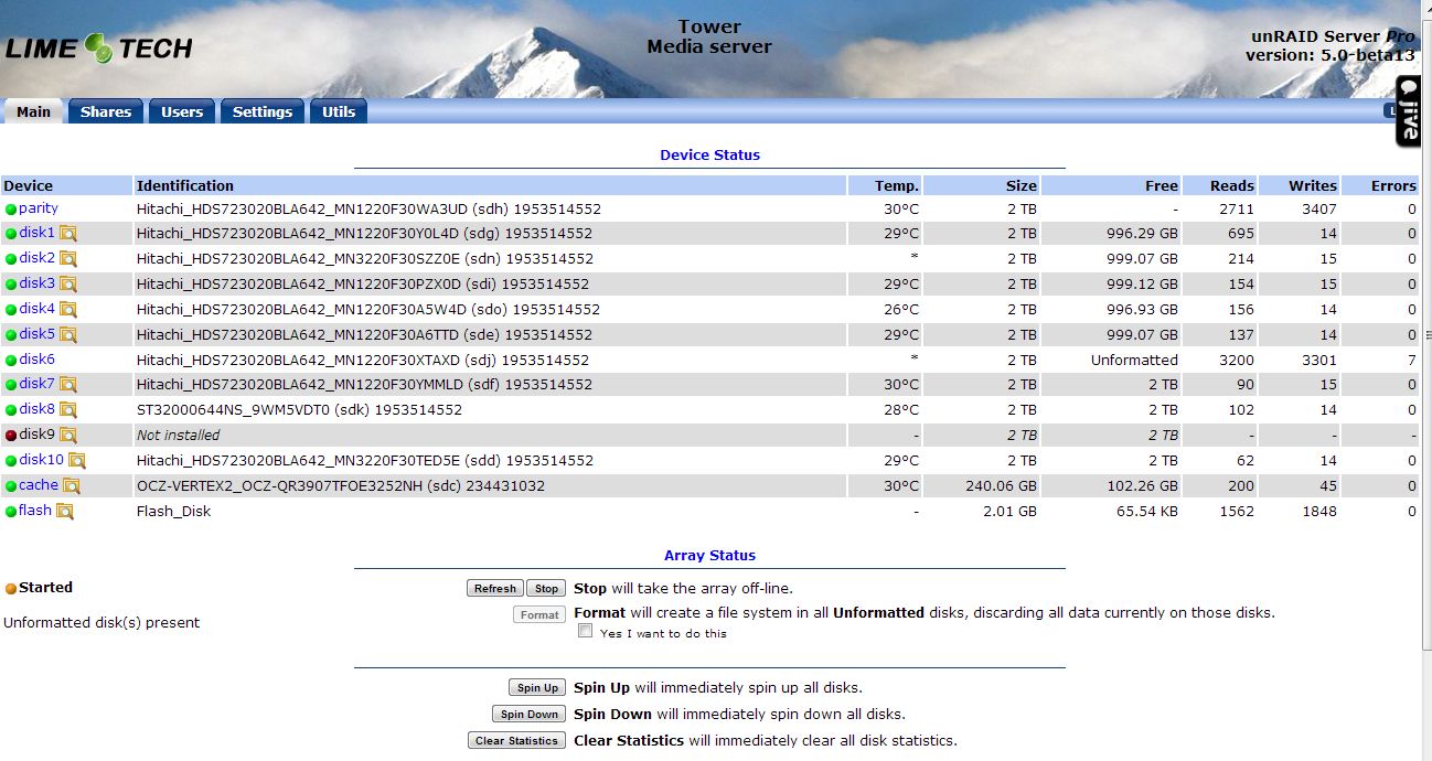

I am currently on the last step of the formatting and it seems like it will finish sometime later tonight.  Should i stop my array and use the new pre-cleared disk for Disk 9 on my system since it is coming up missing? After that i can start working on why the other disk is coming up as "not formated"
Drabert
Drabert
the preclear script DOES NOT format the disk.  It writes zeroes to it and then puts a small signature in the MBR that unRAID recognizes it has been zeroed.
Your approach is as good as any.  Just do not format the disk that is coming up as "not formatted" unless you no longer want any of the data that was stored on it.
Joe L.

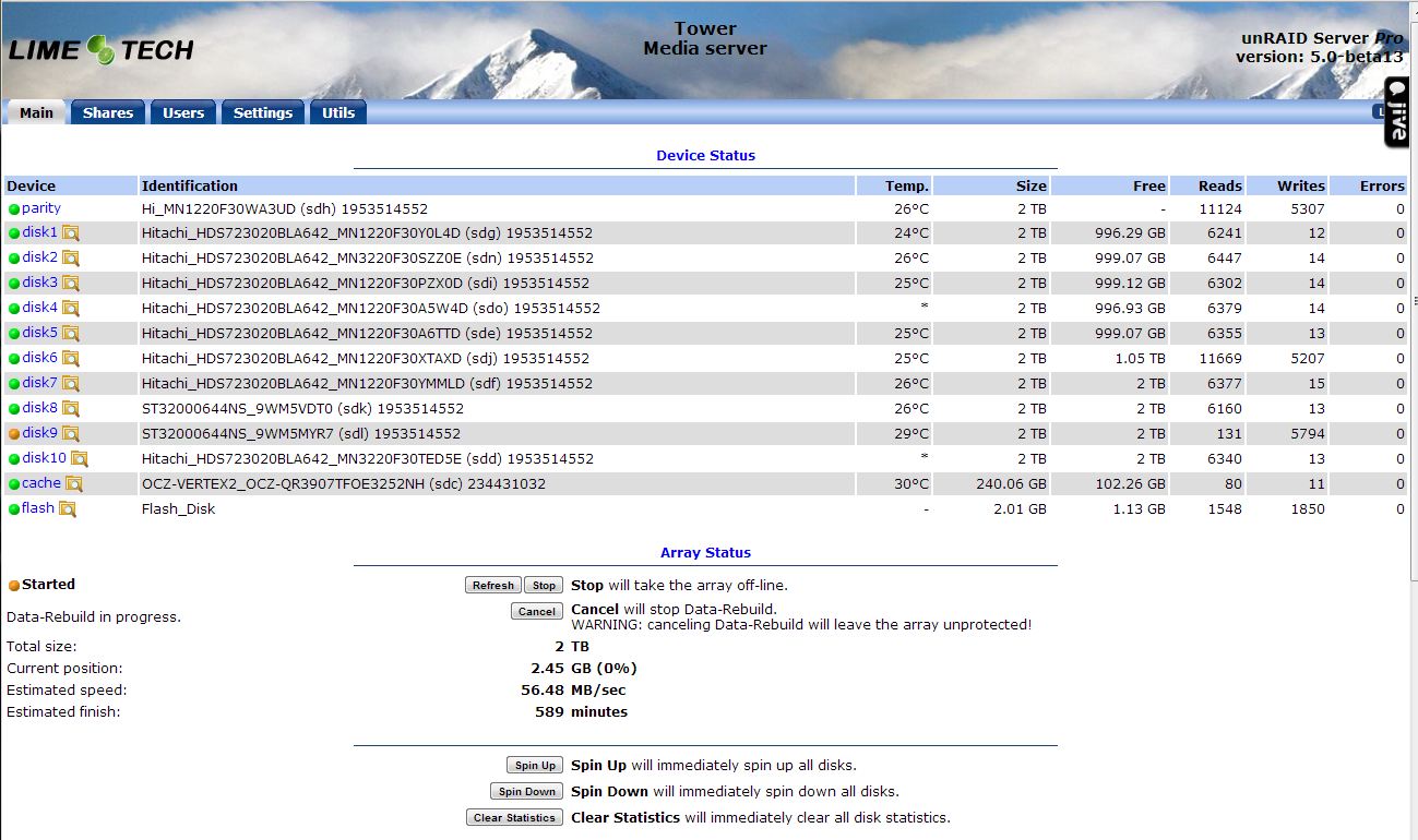

Ok, preclear finished and i have replaced the bad drive with the precleared one and it is now rebuilding.  Once this drive is finished rebuilding, what should my next course of action be? perform a parity check on the system? fail the drive that was showing unformated and have the system rebuild it with a fresh drive?
Over the past two years using unRaid, this is the first time i have had any issues like this.  I have been fighting through a bad chassis for the longest time, but now the WAF is very low since our entire library does not seem to want to stay available.  I am not sure if it is the mover script trying to write to the bad drive that causes everything to get horked, but at this point, i would rather lose a TB of data (its all TV/Movies) than bad WAF :)
added current screenshot

Ok my rebuild finished but now im getting write errors between the drive that was showing that it needed to be formatted and my parity drive.  I am also not able to access the share that has my media files on it.  It is showing all the folders as empty.  Is it safe to replace the drive that looks like it is failing with the hope that the parity drive will rebuild it?
New syslog attached

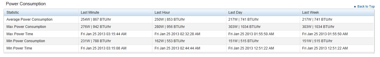

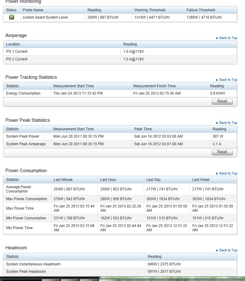

Its only drawing 250 Watts out of 750.
That wasn't the question. How many amps (or watts) are available to the drives?
this is from DRAC power monitoring.  Sorry but im not good with power stuff:
Drabert
What is the exact model number of the PSUs?
