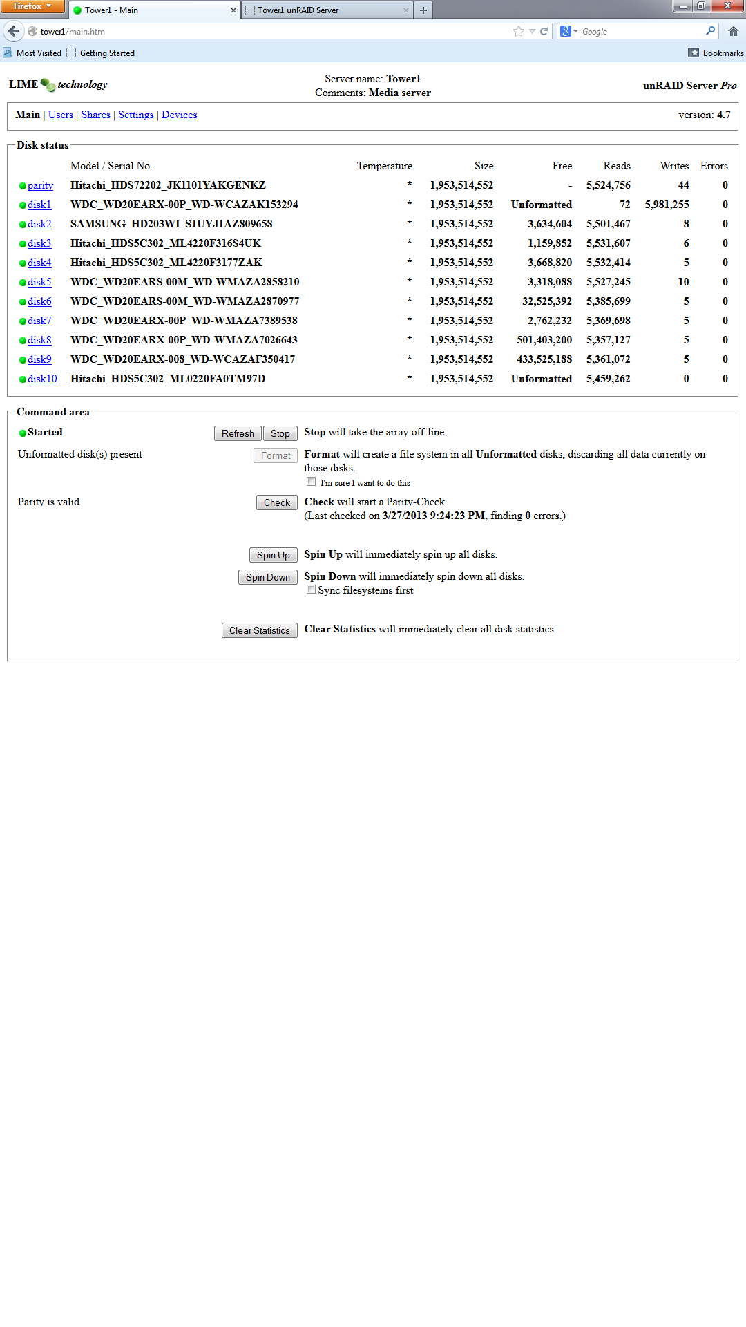

Last Tuesday 3/26, I added some files to disk8 and ran a parity check.  There were errors and disk1, and disk 1 was red balled.  Instead of trouble shooting, I thought it would be easier just to power down and replace with a spare new 2tb drive I had.  I proceded to rebuild.  During the rebuild process I noticed that my disk 10 drive somehow became unformatted and was still green.  I didn't cancel the rebuild to see the results when finished.  The results were disk 1 was not rebuilt and still unformatted.  Disk 10 is unformatted.
I still have the Original disk 1 untouched, out of the array.
I pulled the syslog file from the flash folder on the network and put it in text (just now, so not sure if it will help).  I didn't know every time the array powers down, the syslog resets?  I included a short smart report of disk 10.
Is there any way I can recover data from disk 10?
Has any ever have this happen? red ball one disk then for some reason another is green but unformatted?

disk8 is fine.
disk10 was always green but somehow became unformatted.
How do I recover data from disk10?

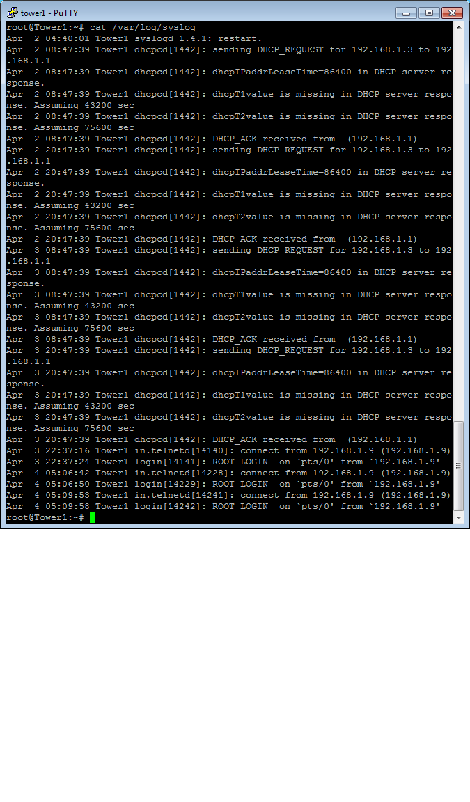

in telenet
cd /var/logs
is says No such file or directory.

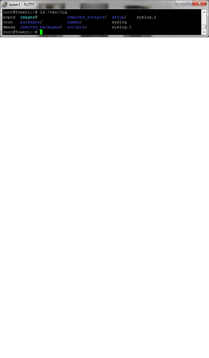

in telenet
cd /var/logs
Thanks.
perhaps because the correct directory name is
/var/log
did a screen capture.  only 4/2 to 4/3
thanks.

You have three system logs.
you can view them from your browser by typing
//tower/log/syslog
//tower/log/syslog.1
and
//tower/log/syslog.2
thanks.  goes only back to 3/31

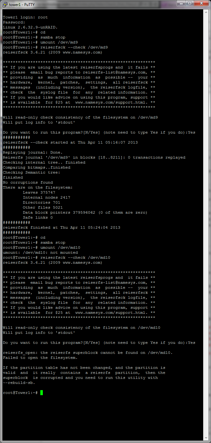

See check file systems in my sig. The /dev/md* devices may not be available. You may have to work on the /dev/sd* devices. You'll need to make duplicates of the disks before starting if the data is not replaceable.
Thanks for the reply.
How do I make a duplicate of the disk?
I ran the check on disk 9, a good disk.  Everything was okay.
I ran on disk 10.  It suggested rebuild sb.
I included screen capture.
How do I duplicate disk 10 before trying to rebuild per your instructions.  I'm new to Linux.
