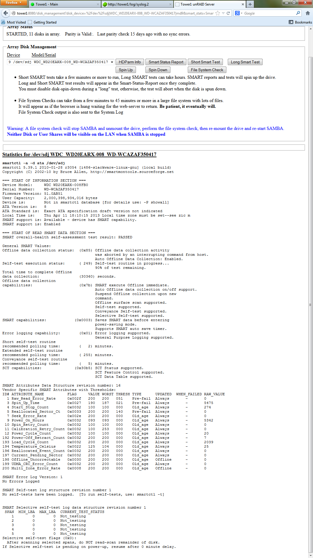

before doing anything, my disk 9 just became unformatted.?????
I have attached short smart report of disk 9.
what is happening?
thanks.

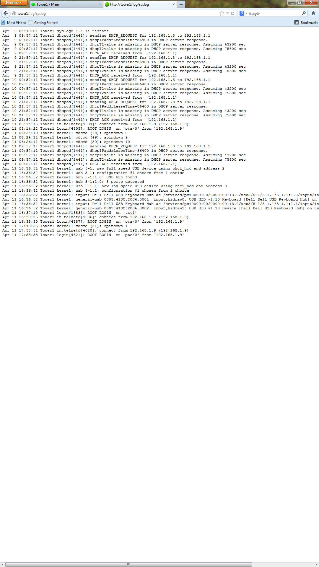

syslog
any advice? :-[
