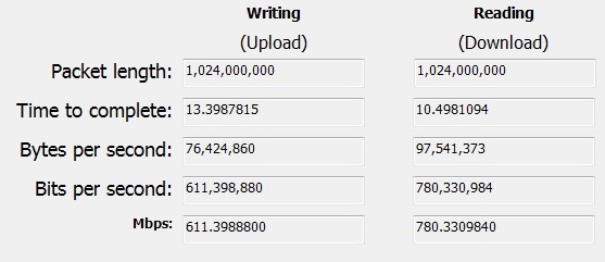

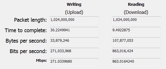

I tried the Lite version of the link provided to test file transfer of a 1024MB file from my Win7 pc to the array.
Results are attached.
Those results look fine!
They show that read speed is good and of the same order of magnitude for both cache and array drives.  Writing to cache is faster than writing to the array although both speeds also look good.
