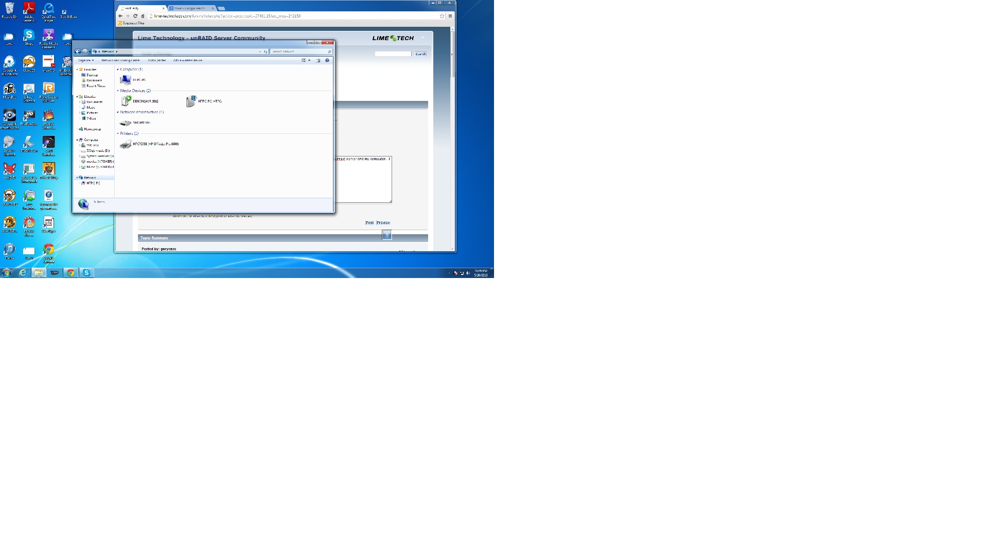

With windows explorer I type tower like I have done in the past but I don't get the control screen.  IP address  doesn't bring u. I only see the flash drive in my computer. Under networks is where I see tower.  What do I need to do to resolve the router and or host file?
You won't see the Web GUI with Windows Explorer ==> do you mean Internet Explorer?

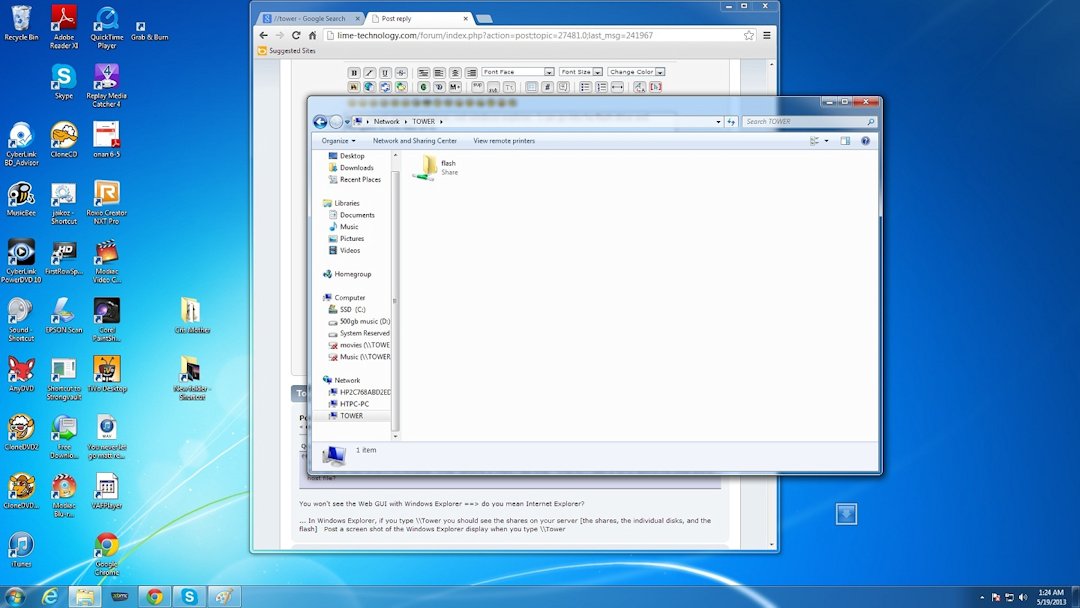

... In Windows Explorer, if you type \\Tower you should see the shares on your server [the shares, the individual disks, and the flash]  Post a screen shot of the Windows Explorer display when you type \\Tower

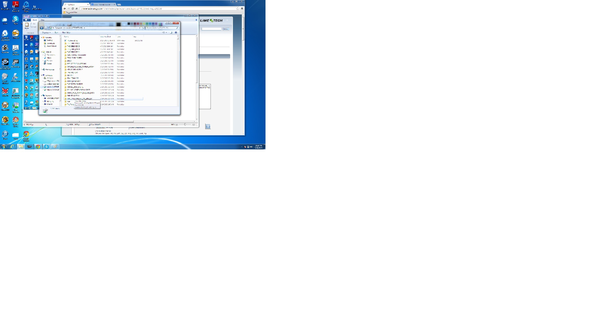

Yes I meant internet explorer, not windows explorer.  I can go into he flash drive and navigate to the files on it.  I attached a screen shot.  Thank you for your efforts.
Oscar
Here is a better screen shot
You're not seeing any of the disks, so it definitely looks like the configuration has been lost ... OR you have somehow disabled the disk shares (and all others).

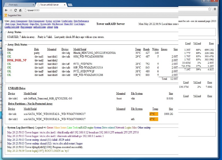

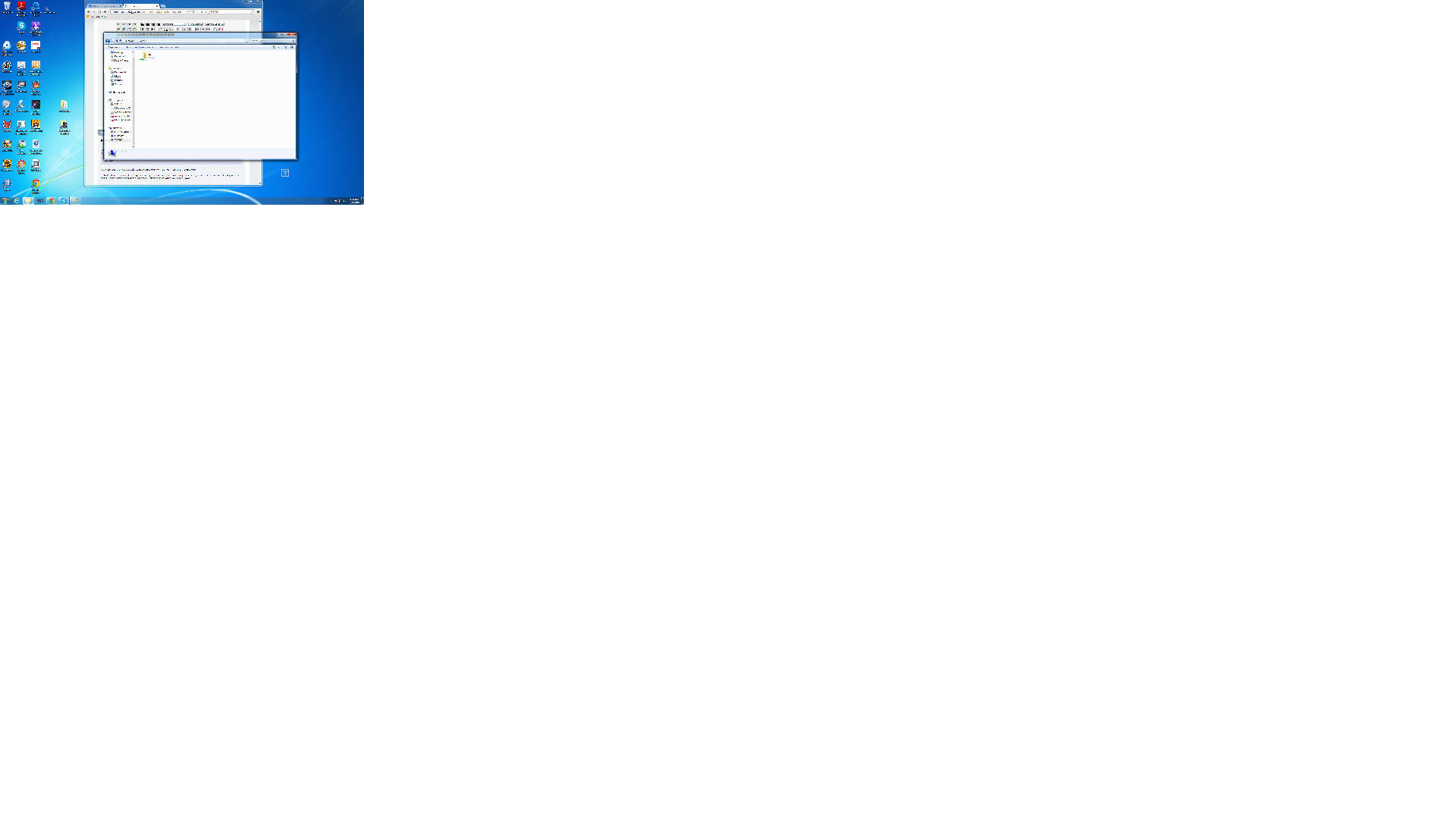

Ok, Sorry for the late reply,  I got home  checked all the connections on the server and fired up the unraid server and my computer.  I opened up windows explorer and now the tower does not show up in the network.  See Pic 1.  So I tried to see if I could see the files that I had mapped.  The files were there in my M:Movie drive and I can navigate to them.  Pic 2.  i am glad that I am able to view files again, but i am not able to see the console.  i was able to get unmenu to come up  Pic 3 it shows that disk 2 is disabled.  I am not sure why.  Anyway, what is my next move?  Why is Tower not showing up in the network?  Feel better ha I am able to see files.  Thanks
Oscar
pic 2
pic 3
