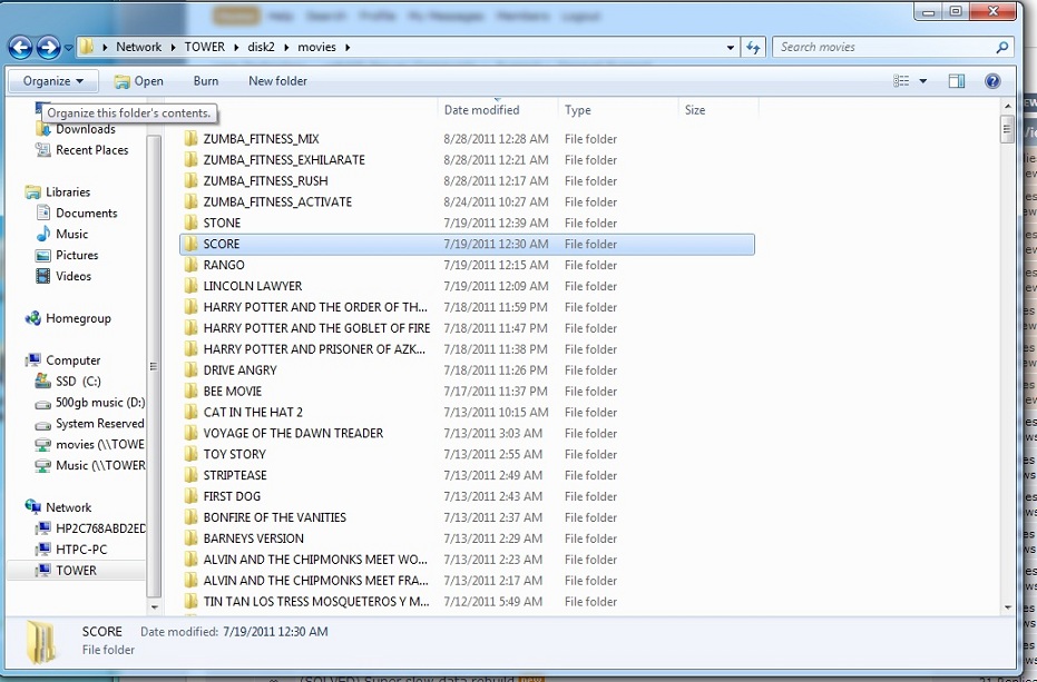

ok update,  went back to win explorer and now tower is showing up.  all disks. even disk which shows disabled. pic 4
Is that weird? Now everything seems to be working fine.

Okay, it's not uncommon that Tower "disappears" from the Network ... but it will often "come back" after you've accessed it via the actual address with Explorer [i.e. \\Tower\Disk1  or \\Tower\Movies ].  The fact that it's been accessed resets the network topology display in Windows.
HOWEVER ... you DO have a significant problem => it seems that Disk 2 has failed.  When you say you can see "... all disks. even disk which shows disabled ...", I believe you're referring to the Windows Explorer display -- correct?
Can you still not get to the Web GUI display?  Try this:  On a DIFFERENT PC on your network (laptop, desktop, or even a tablet) go to your web browser and enter //Tower and see if it shows the Web GUI.
If you can get to the display, what does it show for Disk2 ???
I THINK (but the Web GUI will confirm)  that Disk #2 has failed and needs to be replaced ASAP.  The reason you can still "see" it in Windows Explorer, and access its files, etc., is that UnRAID is reconstructing the data from the other disks plus parity ==> that's what "fault tolerance" is all about !!
