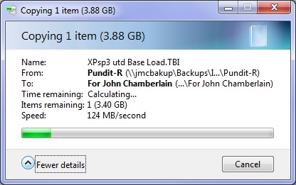

The "absolute fastest possible transfer speeds" are going to be network limited to ~ 120MB/s.  Here's an example of a transfer from my Atom-based system:
