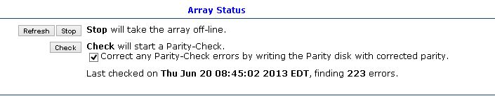

I'm getting many Parity-Check errors. Require assistance to find out why.

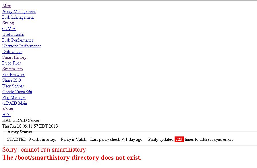

I'm getting allot of parity errors guess I had over 1700 at the beginning of the month and yesterday after running parity check I had over 200. Im running 5.0 RC15a with Unmenu 1.6. I try to get the smart history from unmenu but get the error "Sorry: cannot run smarthistory. The /boot/smarthistory directory does not exist." Any ideas as what could be going on with my system and how I can retrieve the smart history to get some more information posted about my issue?

As I assume you know, if you run a correcting check and it shows 223 corrections (as it appears you did) ... then if you run another check immediately afterwards it SHOULD show zero corrections.
When you ran the parity check, what did the "Errors" column show for each of the disks?

Smarthistory is an add-on package that can be invoked via unMENU link.
If you did not install it, and not run it on a routine basis, there is no history to display.
Apparently, since the directory it creates does not exist on your server, you've never installed it.
