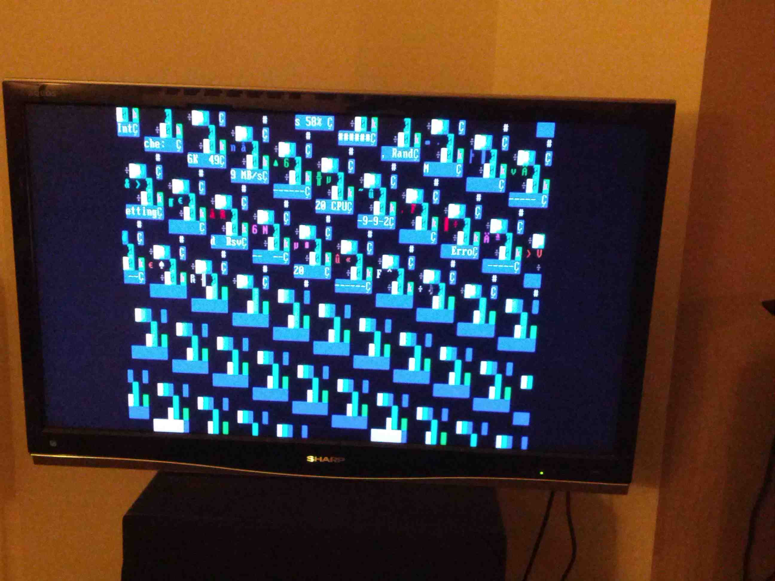

I started memtest on the server and I see some weird behavior.  I took a picture of the monitor while the self test was running (this was the screen about 5 or 10 mins into the test).  The test stayed on this screen for a while (5 maybe 10 minutes) and then the server rebooted itself.  Is there a smoking gun here?  Memory or Mobo?

That looks suspiciously like memory corruption. I'd pull all the memory cards and insert them into the first DIMM slot one at a time, running the memory test for each card. You should be able to identify the culprit that way.
