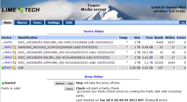

July 9, 201313 yr Hello, something odd happened to me today. I'am trying to copy a file to my unraid setup and after a while i get an error saying that the device has no free space. The disk where i am making the transfer to, has about 1.1TB of free space out of 2TB. This free space is reported correctly on the devices webpage. I tried to copy both to a smb share and directly to the device with the same result. The last messages on the system log are: Jul 9 19:40:46 Tower emhttp: Restart SMB... Jul 9 19:40:46 Tower emhttp: shcmd (38): killall -HUP smbd Jul 9 19:40:46 Tower emhttp: shcmd (39): ps axc | grep -q rpc.mountd Jul 9 19:40:46 Tower emhttp: _shcmd: shcmd (39): exit status: 1 Jul 9 19:40:46 Tower emhttp: shcmd (40): /usr/local/sbin/emhttp_event svcs_restarted Jul 9 19:40:46 Tower emhttp_event: svcs_restarted Jul 9 19:40:46 Tower kernel: e1000e: eth0 NIC Link is Up 1000 Mbps Full Duplex, Flow Control: Rx/Tx Jul 9 19:40:59 Tower kernel: mdcmd (22): nocheck Jul 9 19:40:59 Tower kernel: md: md_do_sync: got signal, exit... Jul 9 19:40:59 Tower kernel: md: recovery thread sync completion status: -4 Jul 9 19:44:09 Tower shfs/user: shfs_write: write: (28) No space left on device Jul 9 19:59:21 Tower last message repeated 250 times If i try to copy the same file to a different disk that has the same size (2TB) but with only a few GB free the operation finishes with success. So the problem isn't the disk size but something related with the disk itself? Any idea of what can be the issue? Cheers,

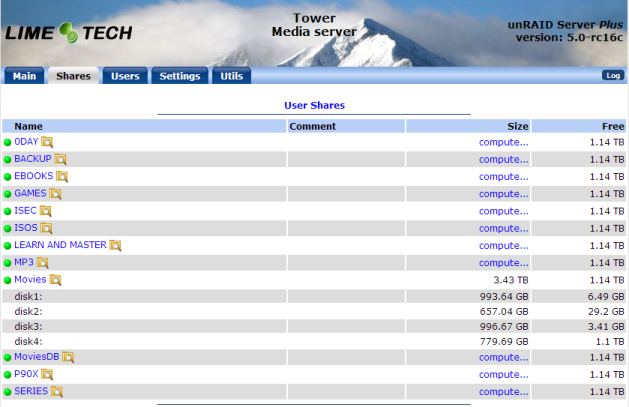

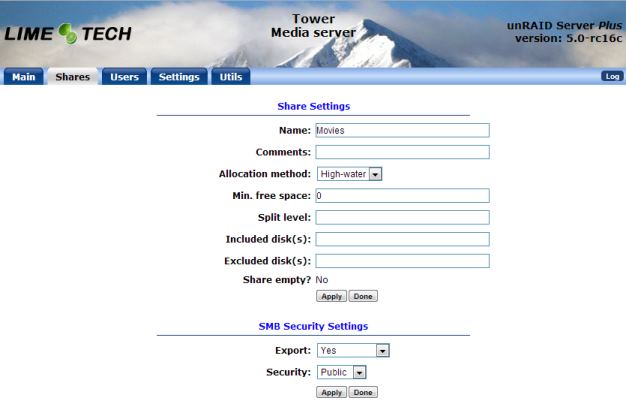

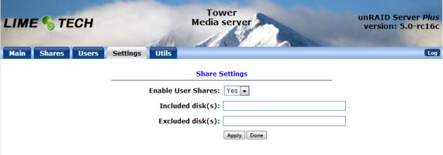

July 10, 201313 yr Show screenshots of unRAID Main, Shares, the share details, and Settings->Share Settings.
July 10, 201313 yr Author Show screenshots of unRAID Main, Shares, the share details, and Settings->Share Settings. Here they are. Thanks,

July 15, 201313 yr Set the Min free Space to double the size of the largest file that you'll ever copy. This will leave a lot of free space but you can top off the drives manually later.

July 15, 201313 yr Can you run the following test, change the "Allocation method:" to "most free" for the movies share and re-test your original "copy both to a smb share and directly to the device". You can change it back afterwards.
July 15, 201313 yr Author Can you run the following test, change the "Allocation method:" to "most free" for the movies share and re-test your original "copy both to a smb share and directly to the device". You can change it back afterwards. Hello and thanks for looking at this. I had actually already tried to do this, nevertheless i tried once more just to be sure. Unfortunately the problem persists... Is just me that think that this is a really weird issue? Cheers,
