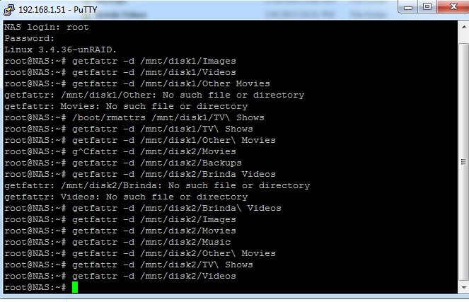

I ran the getfattr but i do not get any errors. System still crashes whenever I try to copy something to disk2 :(

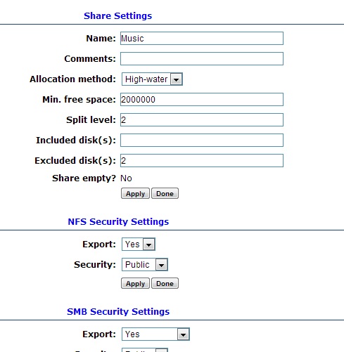

I changed the share settings for an existing share on the problematic disk 2 to exclude disk 2 retaining the split level of 1.
Then I ran mover manually assuming that now the mover would create a new share at the root level of a disk other than disk2 and start copying the contents to it. But this also crashed the server when the first file started copying.

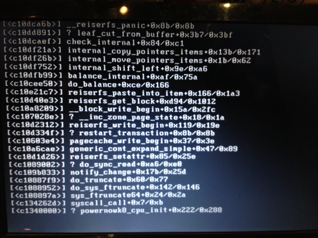

Finally by hooking up a monitor to the machine, I could take a pic of the syslog.
Please refer attachment.
By the way I am also stuck at this screen. Obviously web GUI or Telnet doesn't work. Neither can I type shutdown or any other command directly to the machine using the keyboard. The cursor at the bottom of the above snapshot is just blinking.

Run reiserfsck --check. See check filesystems in my sig.
I ran rebuild tree. Sorry but I didnt know how to get a log. But the trailing text is attached.
