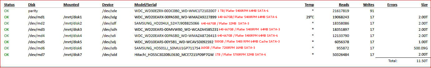

Decide to check on the drives in my server to see what the platter densities were, was quite surprised, all the drives were old apart from the 3TB and the 2TB Toshiba.
Gives me an idea of what ones to replace if i want 1TB / Platter.
