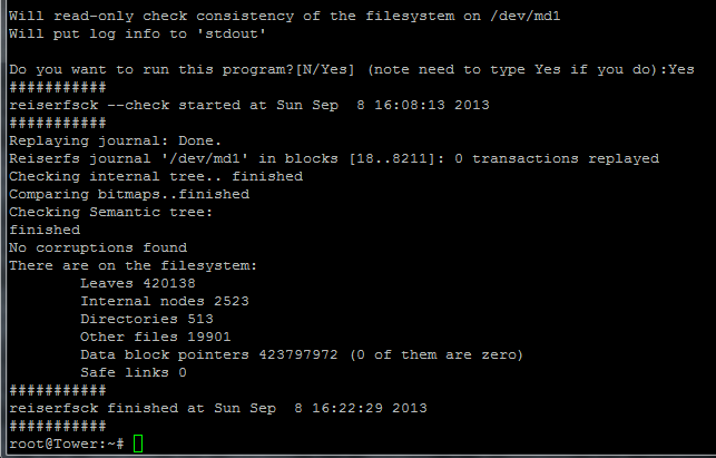

Ran reiserfsck as per instructions in the wiki, but it found no errors.  Stopped and re-started the array again (to get out of maintenance mode), and the two drives are still reporting unformatted.  What next?
Are you sure this is the way to go?  My problem seems very different from the one in that thread, and my reiserfsck results are also different (screenshot attached).  I'm not using a gigabyte board, so that's definitely not the culprit.
Why did you check your first disk when your previous screenshot showed problems with disk 6 and 7?
Sorry, I didn't realize that's what "md1" was.  None of the drives are labeled md1 in the unraid menu, so I figured that was the designation for the whole array or something.
